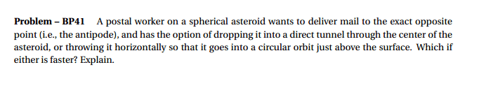

Text problem BP41: a postal worker on a spherical asteroid wants to deliver mail to the antipode, choosing between dropping it through a direct tunnel through the center or throwing it horizontally into a circular orbit just above the surface; which is faster, and explain.
