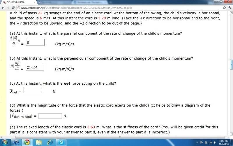

Perpendicular component of momemtum?
The discussion revolves around the challenges of calculating the perpendicular component of momentum in a physics problem. The initial approach using the formula mv²/r with a fixed radius is deemed incorrect due to the variable length of the string. The radius of curvature is critical, as it relies on the elasticity of the string, which is not provided until a later part of the question. Attempts to use the relaxed length of 3.63 meters also do not yield the correct answer. The consensus is that without additional information on elasticity, a definitive solution cannot be reached.
ohheytai
81
IVE TRIED EVERYTHING can someone please help me! i have 1 more try i keep getting it wrong i only can get the first one right pleasee help me!

hi ohheytai! :smile:
this is a really unpleasant question :frown:
i see that you've used mv2/r, with r = 3.7 (the length of the string), to get 214.05
that would be correct if the string was of fixed length, but unfortunately it isn't, so the radius of curvature won't be the same as the length of the string
on the basis of the information at the top of the question, i don't think there's any answer, since the answer depends on the radius of curvature, which depends on the elasticity, which you're given no clue about until part (e) (the relaxed length = 3.63m)
have you tried it using that 3.63?​
doesnt work :(
