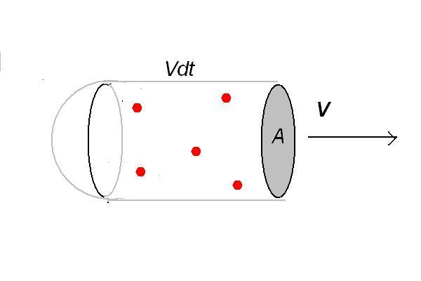

The planetesimal, while traveling with speed v, sweeps a cylinder of cross sectional area equal to A=πR2. In dt time the high of the cylinder is vdt, and the planetesimal collides with every particle inside the cylinder.
ehild
ehild
So from that I would take that the number of collisions per second per unit volume would be something like
dn/dt = πR2vn
would it not?
