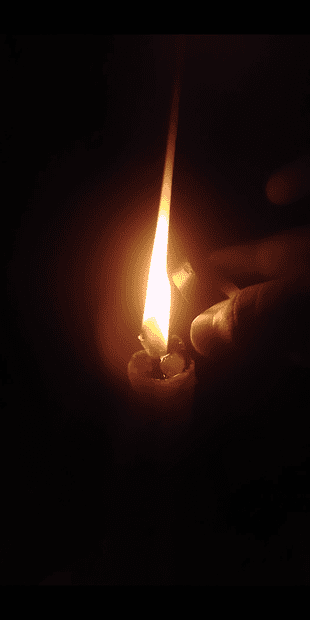

I want to perform an experiment to show that magnetic fields can control plasma. (Can even be a slight repulsion)
Please Suggest one.
I have no idea where I can obtain plasma - I have access to candle flame (though it's not a proper plasma) & fluorescent lights.
I have a permanent magnet (not a strong one), copper wire, cells.
Please be kind to suggest an experiment.
Found looking for "candle flame magnet"
Your permanent magnet won't lead to such a strong effect, but passing it close to the flame might still produce some visible result. Make sure to shield the flame from the movement or air or have a nonmagnetic control sample.

Just to make clear the meaning behind what people are talking about with the shielding - it's about proper experiment design.
To make sure any experiment whatsoever shows what it is purported to show, one needs to 1) eliminate all confounding effects, 2) do a control run.
Shielding the flame is about 1) - you should put a screen (like the aforementioned aluminium foil, or a pane of glass) between the flame and the magnet, to make sure the deflection of the flame is not e.g due to proximity of an object changing the air flow, or its motion disturbing the air.
2) is about using a 'placebo', i.e. you repeat the same experiment with a non-magnetic block of similar size and shape. Should this also show deflection, you'll know there's some other effect that you did not eliminate in step 1), and it's very likely not due to magnetism.

Mfb, I actually observed the repulsion as a slight (I mean really slight) curving of the flame's shape when the magnet was brought really close to it. So, can I conclude that this effect was due to magnetic repulsion of the ions in the atom or is it because of other effects (like O2 attracted to magnet, etc...)?
BTW, just to confirm, if candle flame is not entirely a plasma, then does it contain enough ions to show the repulsive effect?
And is there any other diy plasma experiment I can do (with the aim of showing that magnets can control plasma)?
The whole purpose of these experiments are to really get a gist of what's going on in the tokamak nuclear fusion reactor!
First repeat the test with something similar that doesn't have a magnetic field.
Distinguishing between different effects that happen at the same time will be difficult, but at least you can rule out all non-magnetic effects that way.
We call things a plasma as soon as there are enough ions and electrons to dominate the behavior of the medium, it's not needed to ionize everything.
That would have been useful information in post 1. The magnet and candle experiment is a nice demonstration that a magnetic field can have an effect, but it's nothing like the concept of a tokamak.

This was the result of my first experiment (one I did before posting this Question). It was done in a dark room with all windows closed and almost no air movements. You can see the bending of flame in this image, the same result was seen multiple times.
I tried the same with a steel blade too (though not of the same size as the magnet) and I did not observe any effect such as this.
I will try this experiment again incorporating the suggestion I got here.
