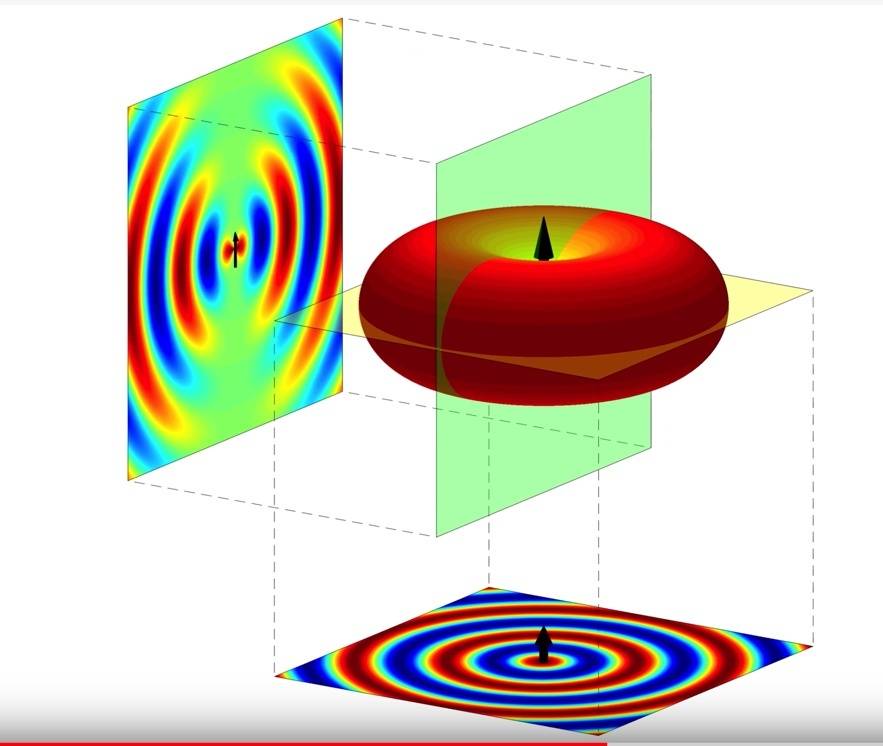

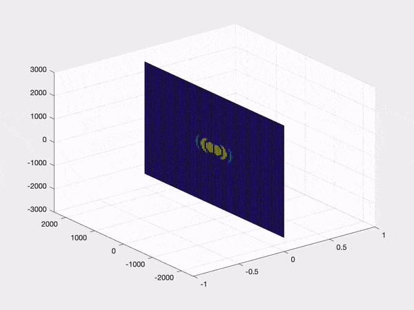

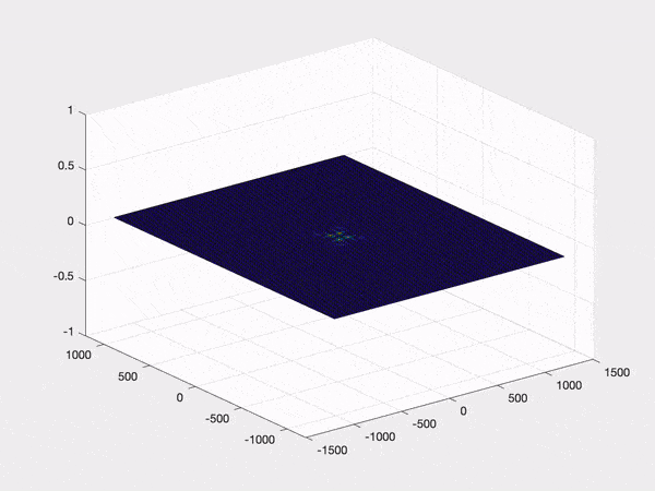

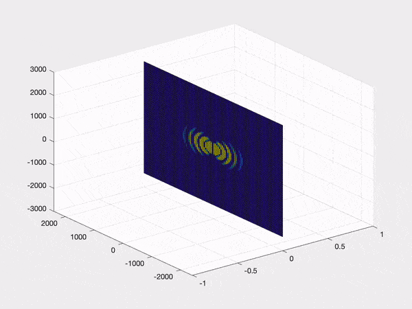

After that my plan is to generalize my dipole script to something like the following so that I can eventually handle the quadrupole (coming up with analytical expressions for this might be hard but I hardly know anything about Finite Element Analysis so I have to come up with analytical expressions).
  • Three-panel 3D diagram of a radiating dipole: a left vertical plane shows colored concentric wave fronts around a central arrow, a green vertical plane cuts a red torus-shaped radiation pattern with a vertical arrow, and a horizontal plane below shows concentric colored rings around an arrow.

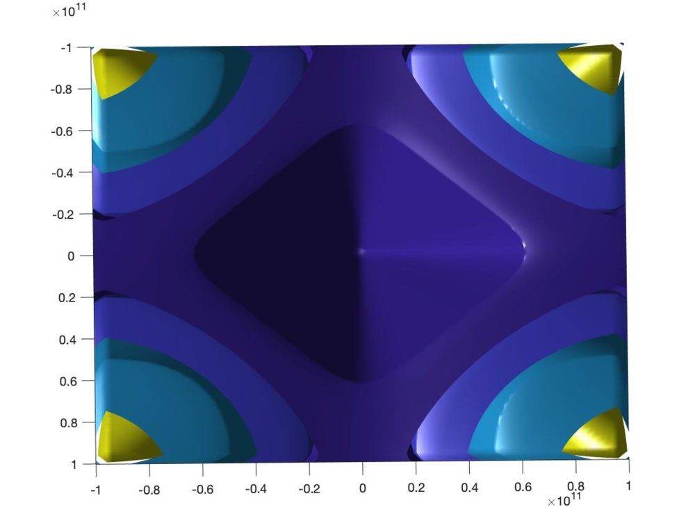

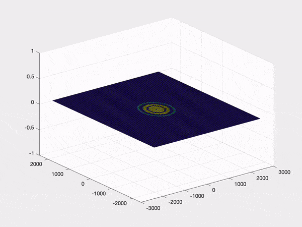

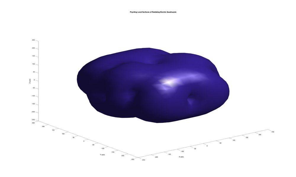

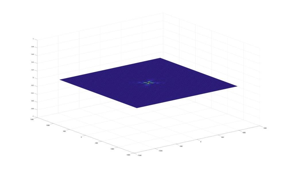

3D surface plot of a blue lobed shape with x, y and z axes from -300 to 300, resembling a dipole radiation pattern, with bright highlights on its surface.
Well I tried to create a 3d animation and I failed pretty bad.
1) The so called "yo-yo" is oriented wrong. I meant for the dipole to be oriented in the z-direction. The lobes should be on the sides instead of the top and bottom. This means I broke up Jackson's expressions wrong component wise.
2) It's not an animation but rather a still picture.
I will continue to work on it. I have to
1) Re-calculate Jackson's expression's component wise so I can re-orient it
2) Find out why my script is not animating. I'll have to look closely at my for loop.
3) Once I find out how to re-orient and animate, I need to learn how to make slices.
Edit: Fixed the orientation but still not animating. The problem was that I was computing the Poynting vector wrong. My image is not as "sharp" was I want it to be...I wonder if that is a limitation on matlab/my computer.

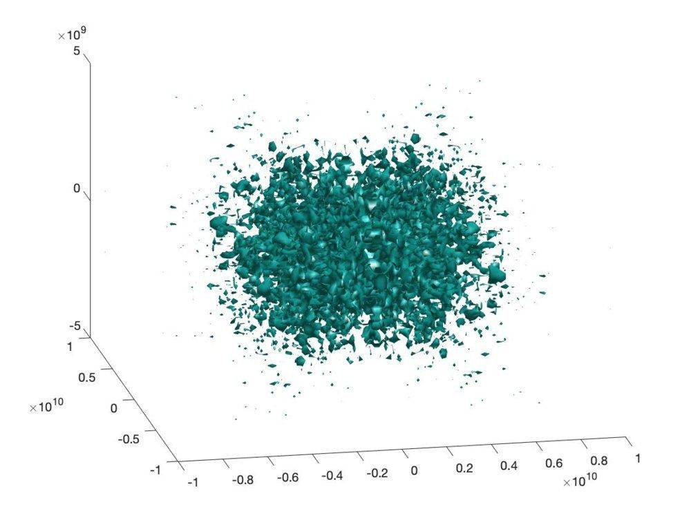

3D MATLAB surface plot of a blue, faceted, donut-like shape with axes x and y from -200 to 200 and z from -200 to 200, shown as a rounded ring-like lobe pattern.
EDIT: nvm I jumped the gun it's not oriented right.

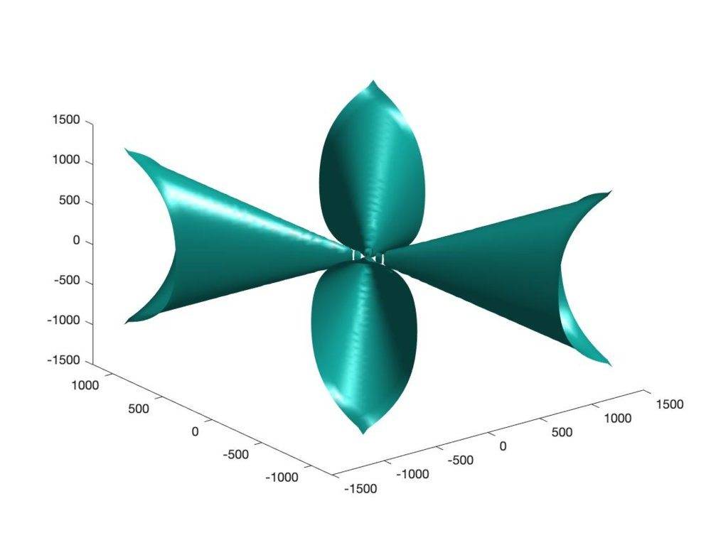

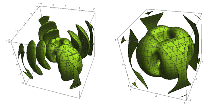

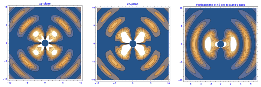

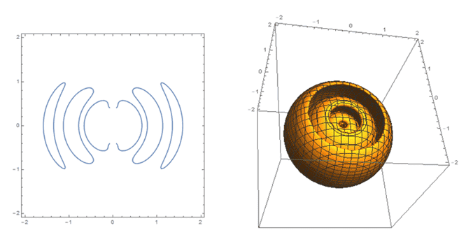

TSny said:
What exactly are you plotting in these 3D figures? Are you trying to get the surface that is shown in the link
http://www.antenna-theory.com/antennas/norm3D1lam.jpg ?
Kind of but not exactly, I should have clarified.
I want to plot level surfaces of the magnitude of the Poynting vector. Basically a 3D version of the gif in post 33. Naturally the outermost level surface will block the view of the rest of the level surfaces.
To me the jpg in the link is a projection of level curves in the xz-plane projected onto a toroid (of sorts).
I believe toroids (of sorts) are the level surfaces of the Poynting vector magnitude but I believe each toroid should be the same color. (I could be wrong)

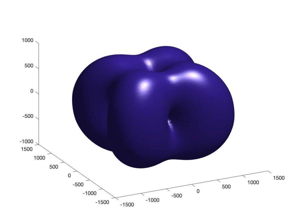

Yes. The 3D version should just be the 2D version rotated about the z-axis. Below are the 2D and 3D contour graphs I got for one particular value of the magnitude of the Poynting vector. The 3D graph is tilted so that we are looking somewhat down from above.
Left: 2D contour plot of a closed curve pattern made of nested arcs symmetric about the vertical axis, axes from -2 to 2. Right: 3D surface plot of a sphere with spiral-shaped contour lines on its surface, viewed from above, with a 3D box frame labelled from -2 to 2.
You are simply amazing. It’s going to be awhile until I have the wherewithal to produce the same graphs as you but I will get there. I’ll work through the night.

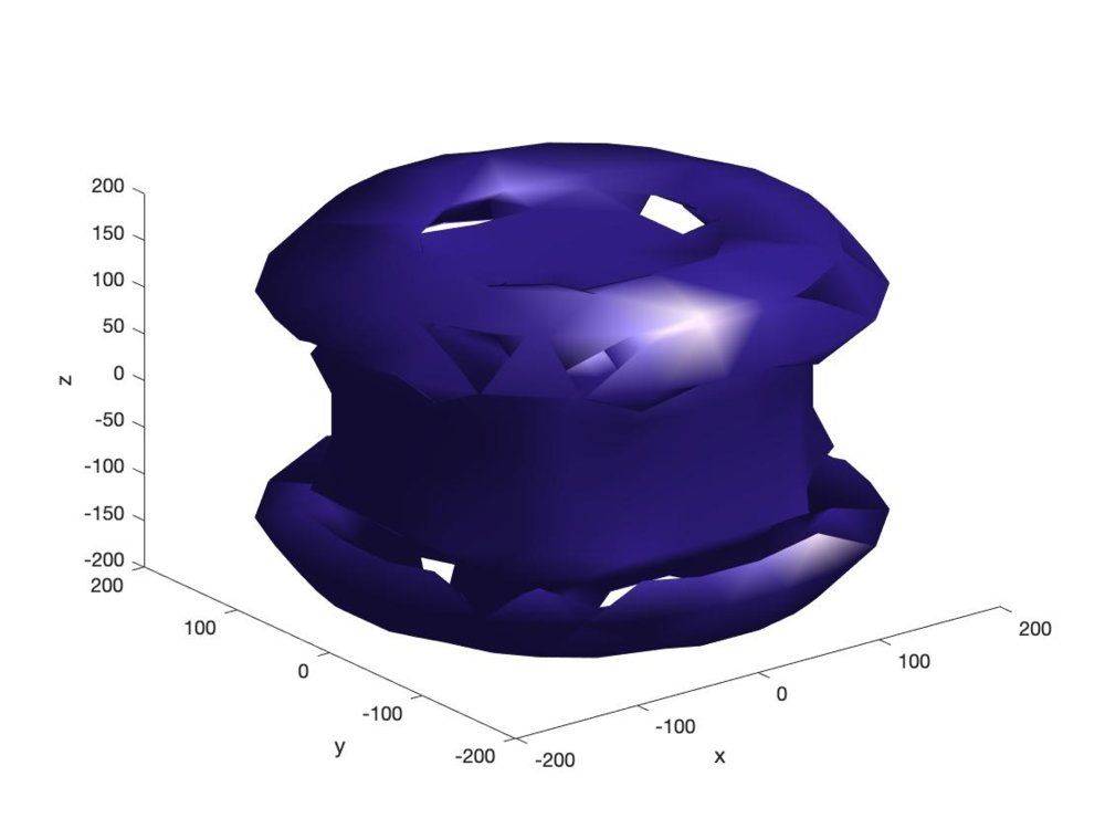

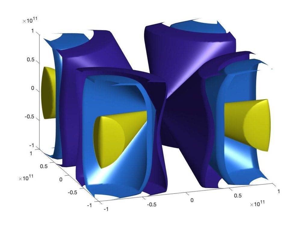

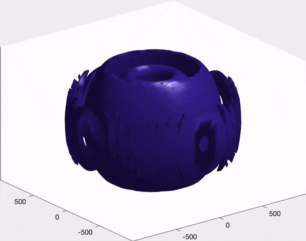

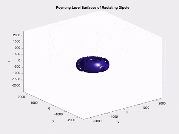

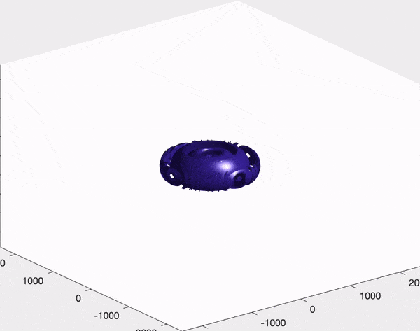

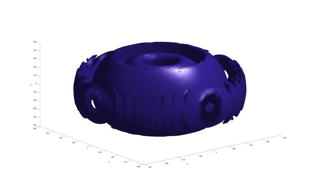

Here's an update
3D surface plot in MATLAB showing a dark blue, donut-like shape with a jagged, fragmented outer shell, axes labeled x, y and z with ticks from -800 to 800.

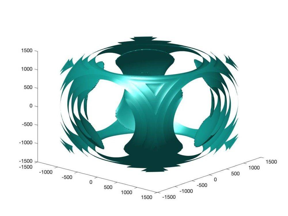

My problematic surface arose from me computing Jackson's expressions wrong. Looking at Jackson 9.18.2 I computed ##(\vec{n} \times \vec{p}) \times \vec{p}## instead of the proper ##(\vec{n} \times \vec{p}) \times \vec{n}##. I computed the rest of the expression(s) correctly as far as I can tell.
Some comments about my program
1) Still not animating, when it does I need to make coordinate plane slices in a subplot
2) Color scheme washes together; in the far field the variances amongst field strength seem to be so minute that they all become one color. Maybe this is a good thing, maybe it's a bad thing but it is worth mentioning. I'd like to make each shell a different color and somewhat transparent.

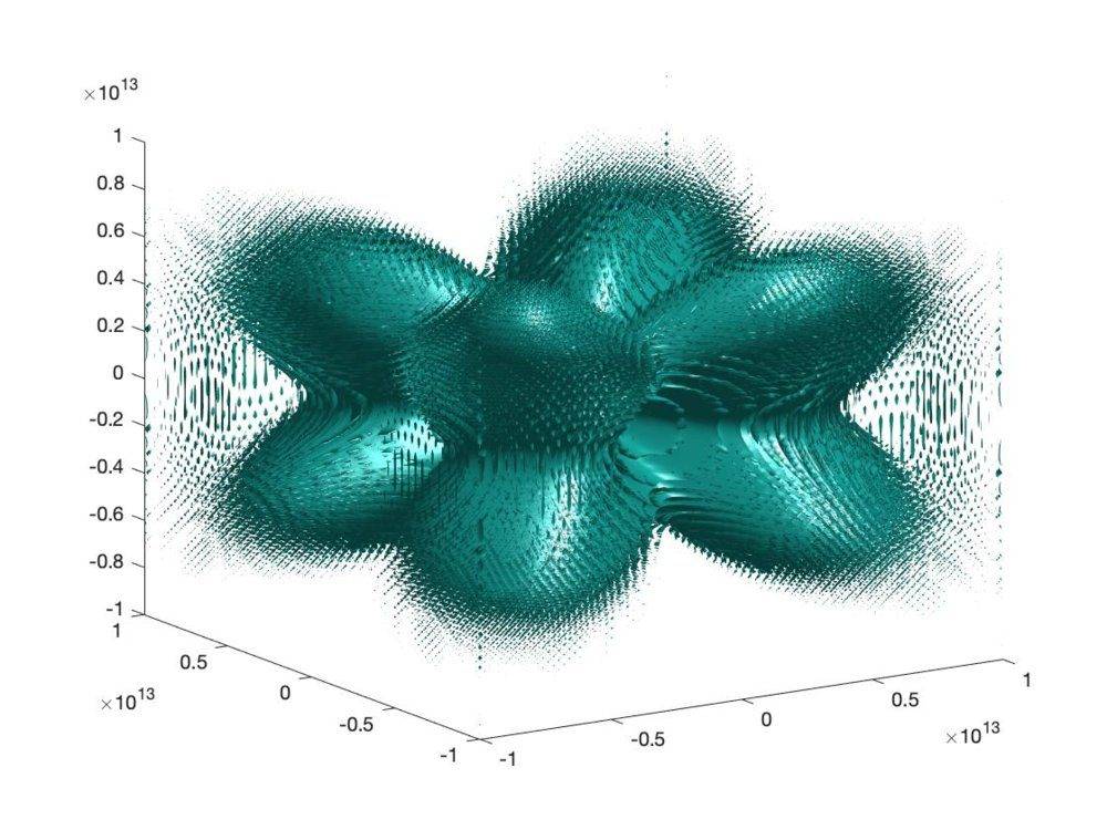

Can anyone think of a clever way to pass a vector of values to a function that only accepts scalars? Using some combination of for loops, while loops, if blocks etc. I want to do it without writing a separate statement for each of the 99 values.
X,Y,Z,
isosurface(X,Y,Z,V,isovalue)
isovalue must be a scalar but like I said I'd like to plot level surfaces for more than just one value without writing a separate statement for each value.
MATLAB 3D isosurface plot of a dark blue, roughly spherical shell with bulbous lobes on the sides and a recessed opening on top, axes labelled 500, 0, -500 on the base edges.
Not Exactly what I was going for but it is progress.
I have no idea why the shells get intermittently taller (and shorter).
Edit: You would think the shells would change size within an envelope and the envelope itself would not change size.
