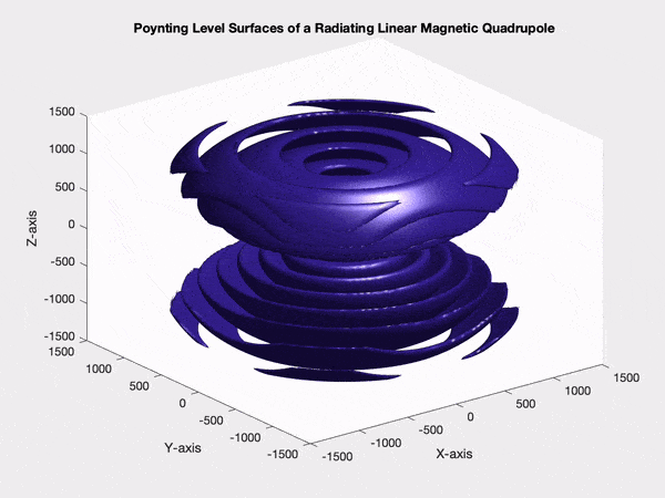

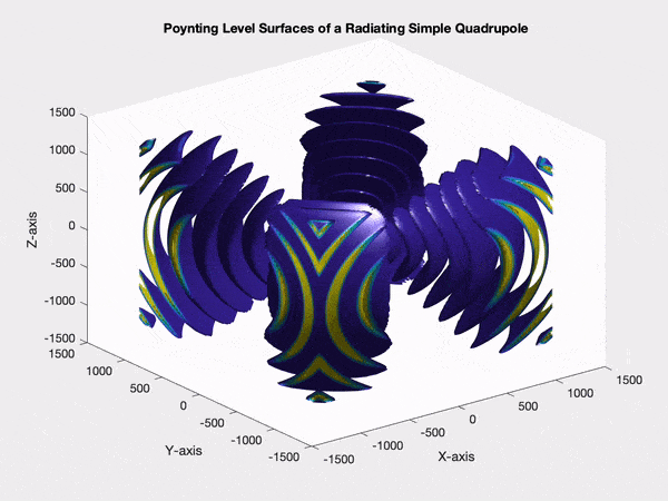

Here's my progress
There are some things wrong with this picture. (please zoom in if need be). I am happy that we appear to have a 4 lobe pattern though.
1) Wave fronts/level surfaces of the Poynting vector seem to be pointing inwards instead of outwards. I could try negating my fields (but that would be really contrived)
2) There's not enough contrast and there could be a million reasons for this.
3) For whatever reason an animation is not rendering in MATLAB and I'm getting an error about how all frames aren't the same size...which is ridiculous considering I more or less copy and pasted my format from the dipole script which did not have this problem.
As a note: I didn't use the fields that Jackson used but rather my own expressions, but they do corroborate Jackson to first order. Jackson uses the approximation that ##\nabla \times \approx \hat{n} \times## in the far field which I think is ridiculous.
I'm trying to do the oscillating electric quadrupole. I suspect that I forgot magnetic dipole terms. Does the oscillating electric quadrupole necessarily produce a magnetic dipole moment?
Please zoom in (I apologize for the scale, I'm working on it) to see that the wave is propagating outwards but the level surfaces (or rather cross sections of level surfaces) appear to be pointing inwards instead of outwards.
I'm off by a phase factor of ##i## somewhere in my purely spatial dependencies because when I multiply by ##e^{i \omega t}## instead of ##e^{- i omega t}## I get the wave propagating outwards. Which runs completely opposite of what is supposed to happen.
This gif/program needs a lot of work.
Summary
1) Off by a phase factor somewhere in my 30 pages of derivations
2) Level surfaces are pointing in instead of out
maybe the 2 problems are related to each other.
Has 6 loves instead of 4 it seems. awful.

That's ok with me. But, one of the advisors or mentors might shut this thread if he/she feels that it's becoming too lengthy.
##\nabla \times \approx ik\hat{n} \times## is a good approximation in the radiation zone when applied to the complex valued expression for vector potential ##\vec A##.
Are you trying to get expressions that are valid in the "intermediate zone" as well as in the radiation zone. If so, I imagine the expressions will be pretty lengthy.

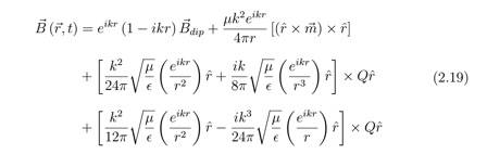

Allow me to explain:
I Believe these are correct.
I also believe the following is true
##\vec{E} = \frac{i}{k\sqrt{\mu \epsilon}} \nabla \times \vec{B}## is true assuming harmonic fields.
Now computing the latter expression for the former is where I'm having lots of difficulty. I incorrectly assumed in my derivation that ##Q\vec{r}## was a spherical construction as opposed to a cartesian construction. So I must convert...a lot of work ahead of me.

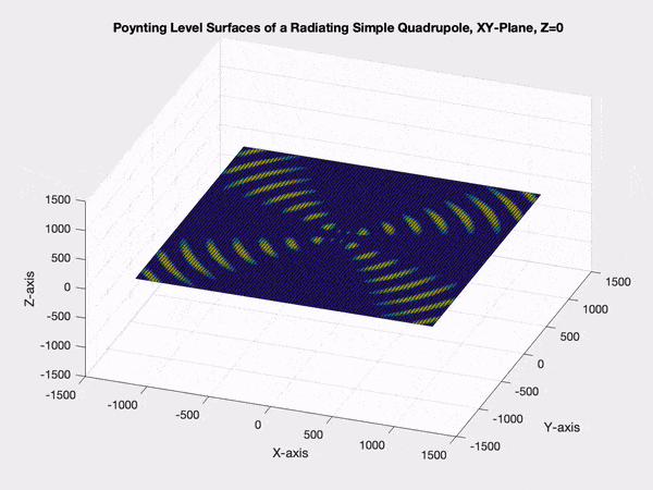

Anyway I used my expression for##\vec{B}##, used the curl function in matlab, multiplied by the appropriate constant, took the cross product, plotted the vector field and got this
I'll keep working on it. This is not exactly what I want but it has enough of what I want to make me think that I made a small mistake somewhere.
I'm going to test Jackson's formulas in MATLAB before I try implementing my own just to compare. Progress I think.
Had to project the vector field radially to get rid of the vectors "in between the lobes" and then make isosurfaces.

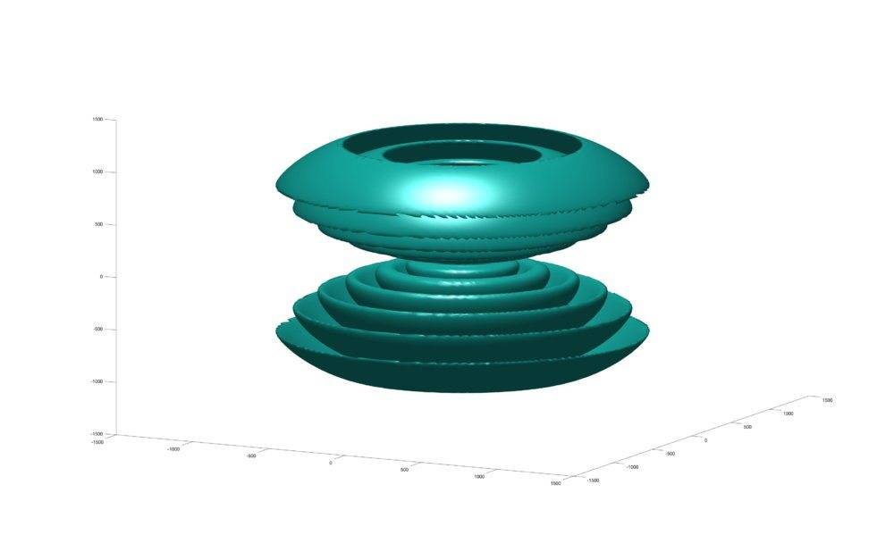

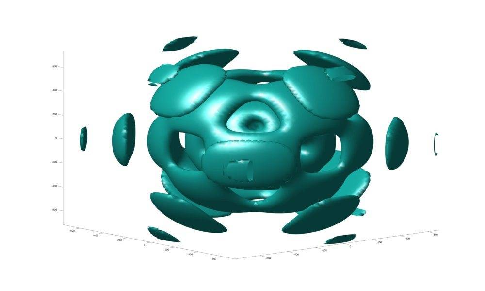

Using my own formulas I'm getting something peculiar. My intent was to plot level surfaces of the Poynting vector for the radiating electric quadrupole at time ##t=0##. It seems like I got an inverted level surface of an octupole pattern.
I feel like this is progress.
I instead plotting Poynting vector magnitude level surfaces I plotted level surfaces of the power radiated per unit solid angle.
##\frac{dP}{d \Omega} = \frac{1}{2} Re\left( r^2 \hat{n} \cdot \vec{E} \times {H^*}\right)##
Edit: I used my own formula for the vector potential on this one and let MATLAB compute ##\vec{H}## and ##\vec{E}##

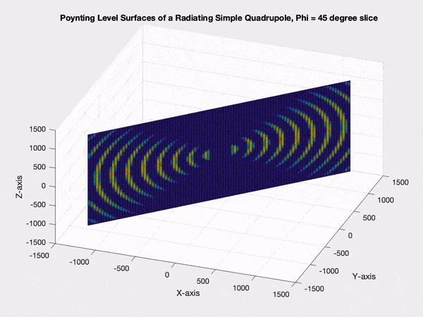

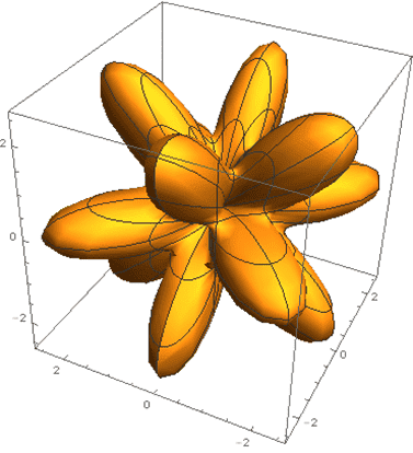

I tried cranking out expressions for the E and B fields. Pretty messy! I doubt if I got it all correct. If you want to compare, here are some contour plots of |S| for the xy plane, the xz plane, and a vertical plane that makes a 45o angle with the x and y axes.
Here's a 3D contour plot for one value of |S|. The figure on the right is a closer look at the center region.
Weird, I only get what you get when I project the vector field radially. Making the vectors in between the lobes essentially disappear.

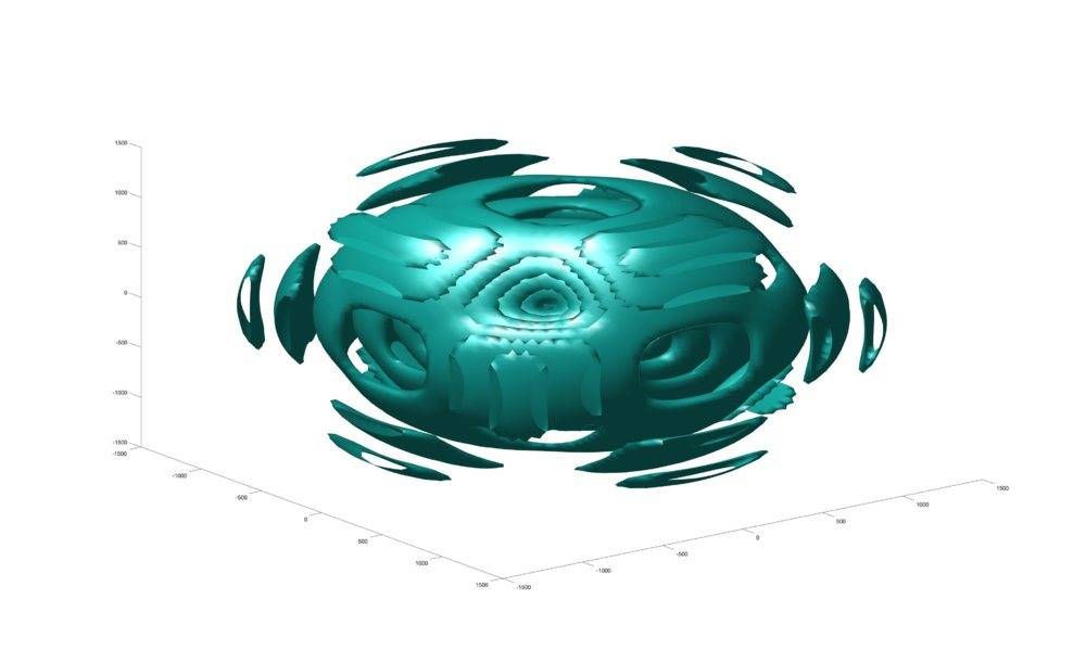

I basically lost a bunch of what I did because I edited it without keeping record of what I did. This is what I've gotten back to. I'm going to try increasing ##k = \frac{2 \pi}{ \lambda}## in my program to get a shorter wavelength. ( I think that statement makes sense...my brain is fried)
Edit: and I get this
If only I could get the purple surfaces to close. It conceal the rest of the level surfaces but it would get us the characteristic shape we want.
Top view, I feel like those level surfaces should be pointing outwards.
Part of me thinks that it's MATLAB connecting level surfaces that shouldn't really be connected.

They purple surfaces might close if you plot out to a greater distance. To get the purple surface to close so that you see all of the "central blob", you need to plot out to a distance of approximately one wavelength.
I notice that you have a factor of ##10^{11}## for your tick marks on the axes. I find it much more convenient to choose the unit of distance to equal one wavelength. By letting ##k = 2 \pi## and ##\omega = 2\pi##, the unit of length is one wavelength and the unit of time is one period of oscillation of the source. (In some of my earlier plots, such as in post #82, I let ##k = 1## which made ##\lambda ## equal about 6.3 units of distance.)
