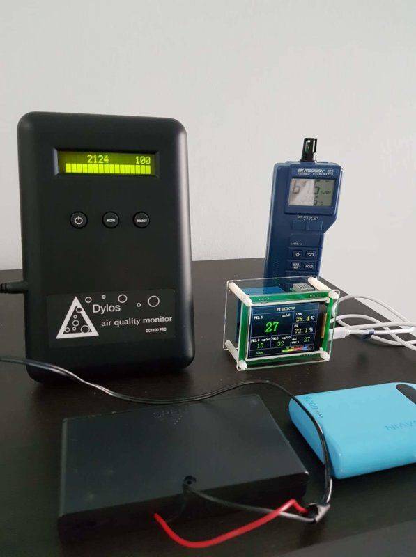

After days of analysis. I opted to get a separate Pm2.5/10 monitor based on the Plantower PMS5003 sensor: http://aqicn.org/sensor/pms5003-7003/
Now I'm looking for the best sensors to detect TVOC, HCHO and Co2. Amazon gave me until Feb 22, 2020 to receive the original multi detector. So I have a week to learn about better TVOC detectors. The one I have now is based on the china made DART Electrochemical sensors (see below). Problem with it is if I blow a breath into the unit inlet. All Co2, TVOC, HCHO suddenly increases 5 times. My breath sure doesn't contain VOC (Volatile Organic Compound) or HCHO (formaldehyde), does it?

I returned the unit in post #1 because it is quite inaccurate and got 2 more accurate ones.
Is anyone familiar with different sensors used pm2.5 monitors?
After returning it, i ordered the Laser Egg which is based on the Plantower 3003 but Amazon didnt send it for days so i changed my mind and got the Dylos instead. These are reviewed in:
https://smartairfilters.com/en/blog/how-accurate-are-common-particle-counters-comparison-test/
After some reading i found out a cheaper product from china ($40) has the more latest Plantower 5003:
https://www.lazada.com.ph/products/28-car-pm25-detector-tester-meter-pm10-pm10-aqi-particle-air-quality-monitor-home-gas-thermometer-i312766766-s631198431.html?dsource=share&laz_share_info=22287687_5_100_500042076257_15363983_null&laz_token=11c153896d8eb2858ce86dff36d10e5d
Now running them together.
This is the right one in another location shown so you can see the labels:
Some puzzles. The PM 10 in the right device is higher than its PM 2.5 while in the Dylos. The bigger particles (the right number on the display) are lesser. What sensor and principle produces more accuracy? Please check these sensors data.
https://aqicn.org/sensor/pms5003-7003/
http://billpentz.com/woodworking/cyclone/dylos.cfm
