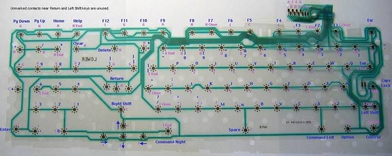

Hello there! I am attempting to use a laptop keyboard I just salvaged from a spare. I noticed the laptop keyboard has a ribbon connection. Further research has told me that the ribbon cable essentially just sents signals to a processor attached to the motherboard. In other words, I cannot use it conventionally. Or can I? I was thinking I could use a microprocessor such as the Raspberry Pi in order to act as the processor. I made a desk that houses my computer inside about a 15" gap between the plexiglass and edge. So if I cut it out and ream it a smidge, I could set the keyboard inside in order to use it with the keyboard. Thus making a keyboard that is integrated into my desk along with a computer. With that being said, am I wrong in my assumptions of this? If so, how does a laptop keyboard work? I attached a picture which makes it seem like it operates as a matrix. So is there any way to do that of which I am trying to do?

You are right, the key switches are wired as a matrix. In desktop computer keyboards, a standard keyboard controller chip is usually part of the keyboard, to interface the key switches to either the (almost obsolete) PS2 connector, or to a USB connector.
In a laptop, the keyboard controller chip is probably on the motherboard rather than on the keyboard (and the functionality may be part of a bigger chip, to save space).
As post #2 said, if you just want a keyboard that works, buy one with a USB interface. If you want an interesting project, build your own interface.
Cool! Thanks guys. Yeah for the most part, I do realize that it would be easier to just use a USB. But I would like to do this as a learning experience as well as...why not!? I know it is not going to be easy...But I would rather do this because I have yet to find a regular keyboard with USB that is as thin as a USB keyboard. The USB ones are so...bulky...
