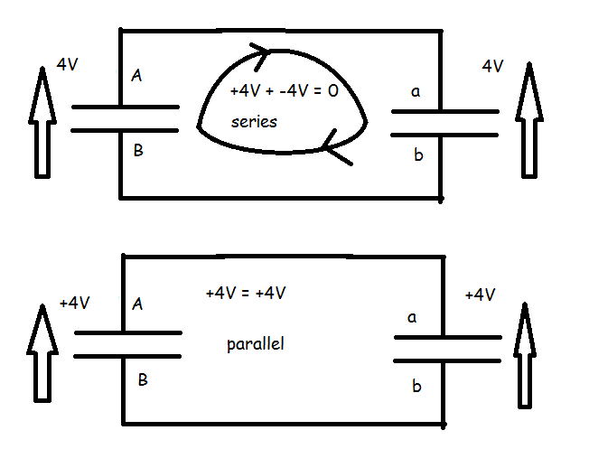

When a fully charged capacitor is connected to an uncharged capacitor with different capacitance, would the p.d. across each of them be the same?
I thought that only the charge stored on each would be the same so p.d. across each would depend on their capacitance? Does that mean that they will not have the same p.d.? If they do not have the same p.d., will the sum of their p.d. add up to be the voltage stored in the originally uncharged capacitor?
How could parallel capacitors possibly not have the same PD? For that matter how could ANY elements in parallel not have the same PD?
Now, whether or not the PD is the same as that on the original capacitor is a different matter. If you add two caps in parallel, what happens to the total capacitance?

I should have stated it more clearly. The fully charged capacitor is only connected with the uncharged capacitor, so shouldn't they be in series in this case? This why I am confused because technically the p.d. should be "split" between the two capacitors when they are connected in series, but my textbook says they have the same p.d.
Does your textbook have drawings or figures for this topic?
If you are connecting just two components together, automatically, they are parallel. The potential across each is the same. The charge distributes proportional to the capacitances capacitances
If these two capacitors have no other connections then they are both in parallel and in series. However, there is a catch.
Make that circuit drawing. Label the two ends on each capacitor. A and B on the charged capacitor and a and b on the uncharged capacitor. If you join A to a and B to b and consider the two capacitors as being in parallel then you have:
pd(AB) = pd(ab).
If you join A to a and B to b and consider the two capacitors as being in series then you have:
pd(AB) + pd(ba) = 0.
When you keep track carefully, you see that you have to flip conventions for the potential difference across one of the two capacitors. The result is that both equations say the same thing.
I'm not sure what you're saying about conventions here?
I think your series equation is exactly what Kirchoff would say. I can't see where any change in convention is required.
My labels are the reverse of yours, but I get P(BA) + P(ab)=0, ∴ P(BA) - P(ba) =0 [since P(xy)=-P(yx) ], ∴ P(BA) = P(ba) or P(AB)=P(ab)

Two circuit diagrams of capacitors A-B and a-b with 4V labels: top loop labelled series with +4V + -4V = 0, bottom labelled parallel with +4V = +4V.
  • Two circuit diagrams with capacitors. Top: capacitors AB and ab in series in a loop, marked +4V + -4V = 0. Bottom: capacitors AB and ab in parallel, marked +4V = +4V.
You have the same capacitor with with the same endpoints and the same potential difference. This is transcribed into equations once as +4V and once as -4V. [Edit, nothing wrong with that. The equations, are, of course, correct]. There must have been some reasoning or some standard behind that assignment. That is the sort of convention that I am referring to.
