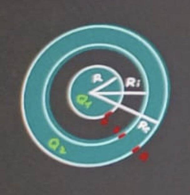

A metallic sphere of radius ##R=3,0\, \textrm{cm}## is located concentrically inside a spherical crust also metallic of inner radius ##R_i=10\, \textrm{cm}## and outer radius ##R_e=12\, \textrm{cm}##. The sphere has a charge ##Q_1=+1,2\, \textrm{nC}## and the clean charge of the crust is ##Q_2=+6\, \textrm{nC}##. Calculate:
a) The charge on the inner and outer surfaces of the crust.
b) Sphere potential and crustal potential (consider ##V_\infty=0##)
The bark is then connected to the ground. Calculate:
c) The charge of the sphere and that of the outer and inner surfaces of the crust.
d) Sphere potential and crustal potencial.
Sol: a) ##Q_{2i}=-1,2\, \textrm{nC}##; ##Q_{2e}=+7,2\, \textrm{nC}##
b) ##V_{\textrm{crustal}} = 540\, \textrm{V}##; ##V_{\textrm{sphere}}=790\, \textrm{V}##
c) ##Q_1=+1,2\, \textrm{nC}##; ##Q_{2i}=-1,2\, \textrm{nC}##; ##Q_{2e}=0##
d) ##V_{\textrm{crustal}}=0##; ##V_{\textrm{sphere}}=250\, \textrm{V}##
Total influence theorem (a)
Diagram of a solid sphere of radius R with charge Q1 inside a concentric spherical shell with inner radius Ri and outer radius Re, charge Q2 on the shell, shown with red charge marks on the shell's surfaces.
a) We know that ##Q_1=1,2\, \textrm{nC}## and ##Q_2=6\, \textrm{nC}##. By the TOTAL influence theorem:
$$-Q_1=Q_{2i}=-1,2\, \textrm{nC}$$
$$Q_2=Q_{2i}+Q_{2e}\rightarrow Q_{2e}=7,2\, \textrm{nC}$$

b) Crust:
$$V_A-V_\infty=-\int_\infty^A E\, dl=-\int_\infty^A E\, dr=$$
$$=-\int_\infty^A kQ_1+Q_2\dfrac{1}{r^2}\, dr=+\left( \dfrac{k(Q_1+Q_2)}{R_e}\right)=540\, \textrm{V}$$
Sphere: ##V_C-V_\infty =(V_C-V_B)+\overbrace{(V_A-V_\infty)}^{=540}##
$$V_C-V_B=-\int_B^C E\, dr=-\int_B^C \dfrac{kQ_1}{r^2}\, dr=-\left[ kQ_1\left( \dfrac{1}{R_1}-\dfrac{1}{R_i}\right) \right]=$$
$$=250\, \textrm{V} \rightarrow V_C-V_\infty =790\, \textrm{V}$$

Ok, so in each case what you have calculated is a difference from ##V_\infty##.
Strictly speaking, voltage is always a matter of potential difference. There is no absolute potential.
A common convention is to define the zero level as the potential at infinity. That is not always applicable, e.g. in analysing infinite charged plates, but it is fine where all the charges are in a bounded region. You are instructed to use that convention here. Hence ##V_\infty=0##.
Does that answer your question or have I misunderstood?

That's it. Thank you very much.
