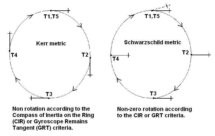

If I may, I would like to briefly return to the issue of gyroscope measurements of rotation.
In the diagram below, the sketch on the left is how a gyroscope attached to a ring that satisfies the ZAM criteria in the Kerr metric, would behave if it simultaneously satisfies the CIR or GTR criteria. Labels T1..T5 indicate successive positions and successive time intervals.
The sketch on the right of the above diagram, is how a gyroscope behaves when attached to a rotating ring around a Schwarzschild black hole. The gyroscope ≈generally≈ continues to point ≈roughly≈ in the direction of the distant stars and and rotates relative to a local point on the rotating ring. The gyroscope does not return exactly to its original location with its original orientation due to geodetic precession or the de Sitter effect and this is hinted at by the dashed line at position T5.
Now consider a Schwarzschild BH that captures a single atom with non zero angular momentum so that it technically becomes a Kerr BH. Would the gyroscope suddenly stop behaving as depicted in the right hand sketch (generally pointing at the distant stars) and start behaving as depicted by the left hand sketch (remaining stationary relative to a local part of the ring) on account of a single atom added to the black hole? This seems unlikely, so it also seems unlikely that a ring that satisfies the ZAM criterion for non rotation in the Kerr metric would also satisfy the CIR or GRT criteria for non rotation in the Kerr metric. As far as I can tell, there would be just be an additional (but lesser?) Lense Thirring precession on top of the de Sitter precession.
  • #53
Firstly, I agree with both your sketches (once the caveat with the de-Sitter precession is added in as you noted) with regards to the compass of inertia criterion (and the equivalent gyroscope tangency criterion), at least upon a first glance. If I again call the 4-velocity field of the time-like congruence describing the ring by ##u^{\mu}## then we will have ##u_{[\gamma}\nabla_{\mu}u_{\nu]} = 0## as proven earlier in the thread; based on Proposition 3.2.1 in the notes I linked earlier, this is equivalent to the condition that ##h^{\mu}{}{}_{\nu}u^{\gamma}\nabla_{\gamma}(h^{\nu}{}{}_{\sigma}\psi^{\sigma}) = 0## i.e. that the tangent field ##\psi^{\mu}## to the ring is Fermi-Walker transported along the worldline of a gyroscope mounted on the ring. The only way for this to be possible, based on the geometrical picture of the tangent field ##\psi^{\mu}## to the ring, is for the gyroscope to continuously change its spin axis relative to a distant fixed star of the asymptotic Minkowski frame in exactly the manner which you have drawn in your left diagram.
In the Schwarzschild case the ring would not satisfy the compass of inertia criterion because in this case ##u_{[\gamma}\nabla_{\mu}u_{\nu]} \neq 0## i.e. it would not be non-rotating according to a local compass of inertia. Consequently ##h^{\mu}{}{}_{\nu}u^{\gamma}\nabla_{\gamma}(h^{\nu}{}{}_{\sigma}\psi^{\sigma}) \neq 0## along the worldline of a gyroscope mounted on the ring and hence the angle between ##\psi^{\mu}## and the spin axis of the gyroscope must be continuously changing. If there were no de-Sitter precession then the spin axis would thus have to be pointed towards a distant fixed star throughout the trajectory as in your right diagram but there is a de-Sitter precession which obstructs that, as you noted. Regardless, ##\psi^{\mu}## must rotate relative to the spin axis of the gyroscope in the Schwarzschild case unlike in the Kerr case for the aforementioned reasons.
So again at first glance I agree with your diagrams themselves. However:
