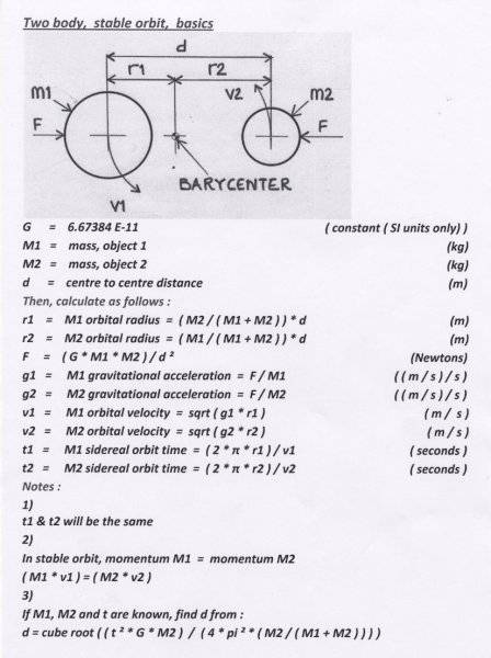

Your initial equation works, transpose for T
Take at look also at the attached sheet. (for information only)
