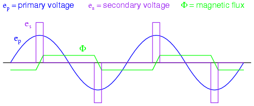

I'm not sure the phasing is correct on this one,
saturation doesn't have to occur at sinewave peak
but how nicely his picture conveys the derivative relation between flux and Vs !
http://www.allaboutcircuits.com/textbook/alternating-current/chpt-9/practical-considerations-transformers/
Special transformers known as peaking transformers exploit this principle to produce brief voltage pulses near the peaks of the source voltage waveform. The core is designed to saturate quickly and sharply, at voltage levels well below peak. This results in a severely cropped sine-wave flux waveform, and secondary voltage pulses only when the flux is changing (below saturation levels): (Figure http://www.allaboutcircuits.com/textbook/alternating-current/chpt-9/practical-considerations-transformers/#02314.png)

Hi Jim!
I did read a bit about peaking TXs but I didn't see that page, that's great. Peaking TX has an extra secondary winding that would Resonate with a capacitor, to capture the harmonics, from memory.
So that picture is pretty indicative of how any es will react in any transformer? Not just a peaking transformer?

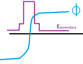

I have some issues to nit-pick about that picture, see where the flux goes up linearly and the derivative of that is a steady es, wouldn't in reality that section of flux increase still look like a sineusoid going from -90o to 90o, and the flux wouldn't be flat, it'd just be a very shallow increase. See my interpretion of a normal saturating transformer:
I still need to read that page you linked to better, but what do you think?
i agree with you
search on saturated transformer and you'll get photos of actual oscilloscope traces.
glad to see you're working derivatives in your head now ! ""Progress through patience , perfection is an asymptote..."

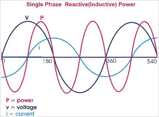

?? You're not thinking again...
That's basic to ohm's law for AC .
When Z is reactive, voltage and current are not in phase .
Draw yourself two sine waves one above each other 90 degrees out of phase.
Look at instantaneous power flow
Observe that
whenever volts and amps have same sign their product is positive, ie power flows into the reactance
when their signs differ power flows back out of the reactance
that's what reactance does, cycles power back and forth between itself and source,
Have you never made this sketch?
hence the old adage "Inductors and capacitors draw only imaginary power:.. "
Hogwash !
They draw very real power but it's only borrowed for a quarter cycle then returned.
So it averages zero.

NO! I've never actually made that sketch, but I like it a lot! Ok, humour me though, say there are two inductors, one inductor is the inductance of the leakage flux and one inductor is the inductance of the core.
So there are two stored inductive energies. Both these energies come from the primary excitation, so are both these stored energies returned to the primary excitation supply?
Cheers!
ps that sketch is at http://www.electrical4u.com/electric-power-single-and-three-phase/

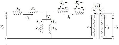

Ah of course *>hits head<*, I totally forgot about the parallel resistance to the magnetising Xm, oh dear, my mind is like a sieve when I don't practice this in a few months. (yeah so the Rc takes care of the magnetising losses. I suppose if you wanted to improve the Ideal TX model to make it more realistic, you could put a resistor in parallel to the Leakage Reactances to model any small losses caused by the leakage flux inducing magnetic losses in the real world outside of the TX.
Thanks for confirming that the inductance is only relevant ot the primary side of the ideal TX.
Hmmm...
Seems thinking has converged ... rewarding to see "the light come on", isn't it ?
It's worthwhile spending the time to become conversant in the model of a real transformer
this one at Wiki is just one of many similar
https://en.wikipedia.org/wiki/Transformer
when you can explain what physical effect each component represents ,
and how you might measure it
you are well equipped in the transformer department.
