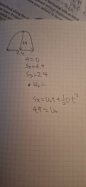

i try to solve it but it didn't work
1. You have mixed up vertical and horizontal displacements.
2. The given vertical displacement is from launch to max height, but the given horizontal displacement is for the whole trajectory.
3. Only the horizontal acceleration is zero. You need an equation involving vertical acceleration.
