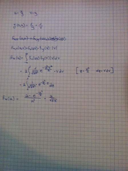

didn't quiet understood what Dickfore did , so tried changing variables in the attached file
seems to me pretty close but something is missing(besides the boundaries of the p.d.f) or i didn't calculate right ,

think i managed to do it, in two ways , could you confirm please
Yes the second way is how I did it. You made a mistake in the last line. When you substituted [itex]z=y^2/2[/itex] you should have ended up with an exponential term of [itex]e^{-t^2 z}[/itex] instead of the [itex]e^{-t^2 z/2}[/itex] which you have written.
o.k! yes i know i did some silly mistakes was doing this h.w in work...
what do you think on the first page , the method of changing variables ?

wuid said:
uart , you have anything on the second method ?
Yeah, that looks ok too.
