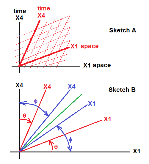

  • #124
Let's hope this might help?

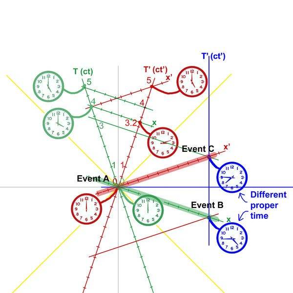

In following case you do have different clock displays per different observer frames:
Event A: red and green clocks pass each other.
At event A, red frame reads a different proper blue clock display (blue clock event C) than green frame does (blue clock event B)
Note that here both green and red frame measure same coordinate time length (about 3.4 seconds).

  • #129
But they are reading the cock at different events! Is that due to relativity of simultaneity?
And why are the clocks that are 'time dilated' showing smaller durations?
Albert Einstein (1879–1955). Relativity: The Special and General Theory. 1920. XII. [B said:
The Behaviour of Measuring-Rods and Clocks in Motion][/B] As judged from K, the clock is moving with the velocity v; as judged from this reference-body, the time which elapses between two strokes of the clock is not one second, but [...] a somewhat larger time. As a consequence of its motion the clock goes more slowly than when at rest.
I.E. the moving clock goes 'more slowly' in that each 'tick' takes longer... the display shewn by the clock must be the same (ref. previous post); which means it is only measured to be slow in relation to the observer's clock(?)
implies that a moving clock is measured to 'tick' more slowly that the resting observer's clock.
The observer in the resting frame measures longer ticks for the moving clock = time dilation.

  • #133
Mister T said:
That's not an example of what I'm talking about.
I never said it was. I gave an example where they do read different clock dispays. (I thought this being of interest in this topic about twin paradox...)
In post #126 I agreed with you a clock display of a clock event is absolute.
