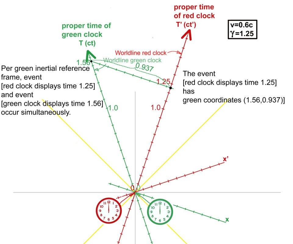

I think Ebeb is on to something here with his understanding of 3-D frames as cross-sections of a 4-D physical space. Bartolomeo points out the continual changing of the individual particles making up an object. We can understand a collection of 4-D fibers (making up an object) strung out along the 4th dimension with some fibers peeling away while other new fibers join, while still maintaining a 4-D object. And of course observers whose 4-D fiber bundles are oriented differently from each other (different speeds) will observe different 3-D cross-section views of the 4-D object.
I'm sure when Dale commented about expecting his table to still be there the next morning he had in the back of his mind that he expected the 4-D table to extend for many billions of miles into the 4th dimension--he anticipated another continuous sequence of 3-D cross-sectional views of the table as he raced along the 4th dimension at the speed of light.

@Ebeb @tophatphysicist @Bartolomeo
I am not sure if any of the most recent posts are supposed to be relevant to the question of whether a reference frame is mathematical or not. I am also not sure why this is such a hard idea. Measuring devices are physical, reference frames are mathematical. I don't get why this is even a point of discussion.

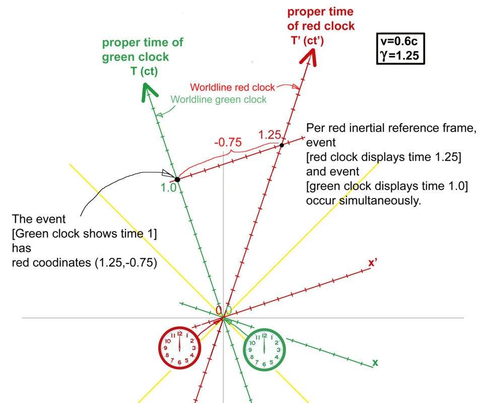

Good commentary, Ebeb. And I was particularly impressed with your space-time diagrams (124 & 127). It presents so clearly what you are saying. I had forgotten that particular quote of Einstein's. It's good to be reminded from time to time.
  • #175
