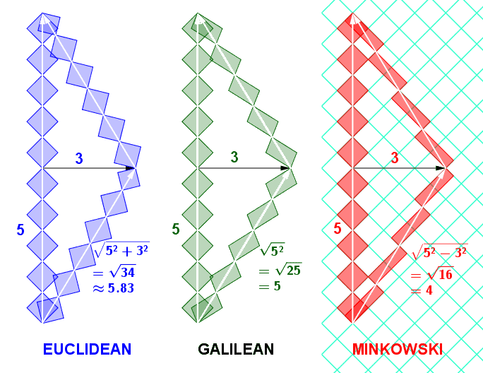

Another way to look at it is by the principle of maximal aging. We have 2 events in spacetime, the departure from Earth, and the return to Earth. Both twins are present at each event. The staying twin's worldline through spacetime between these two events is inertial-- he never accelerates. Thus, his path between these two events is the shortest possible path in spacetime (a single straight line on a Minkowski diagram). The traveler, on the other hand, leaves and comes back. His worldline isn't a straight line, and thus its overall length in spacetime is longer. It includes at least one instance of acceleration. The principle of maximal aging says that the shortest (inertial) path between the two events is the path of maximal aging (it's the path upon which the most proper time passes). This means that the longer your path through spacetime between two events, the less proper time is experienced along that path (approaching a light-like path, where the proper time elapsed approaches 0). Since the traveling twin's path through spacetime is longer than the staying twin's, it involves less proper time.
No, it's the longest. Proper time is the path length through spacetime, and the stay at home twin has longer proper time.
No, shorter. See above.
The inertial path is the longest; proper time = path length. See above.

No, the "length" of the world-line is the proper time. There is no other concept of "length" in Minkowski space (or a general space-time). That you are drawing your Minkowski diagram on a piece of paper with a natural Euclidean metric is irrelevant. Furthermore, in GR (or even just curvilinear coordinates on Minkowski space) this completely depends on your choice of coordinates and what form the metric takes in those coordinates. Given your avatar, you must be aware of this already.

Aside from the error of using "shortest [Euclidean-] length" instead of "longest [Minkowski-]length" (as others have mentioned), the main idea is okay.

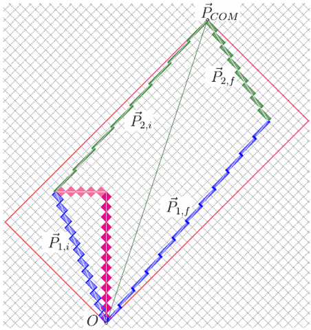

A spacetime diagram on rotated graph paper may help quantify the metrical relations on a spacetime diagram because it is easy to draw the ticks of light-clocks carried by various observers.
Here is the Twin Paradox/Clock Effect for two non-inertial travelers (with there-and-back speeds of 3/5 and 4/5) and the inertial stay-at-home twin.
You can verify that the time-dilation factors ##\gamma=\frac{1}{\sqrt{1-v^2}}## are 5/4 and 5/3, respectively, which could be read off the diagram.
(Note that there are segments of 5 inertial reference-frames shown on this diagram:
Alice, outgoing-Bob, incoming-Bob, outgoing-Carol, incoming-Carol.
You can't easily draw this on two-observer graph paper or hyperbolic graph paper.)
Spacetime diagram on rotated graph paper showing Alice's vertical worldline from O to P, with Bob and Carol's zigzag worldlines, segment labels 5, 4, 3 and 4, 3, 5, and events marked on the paths.
