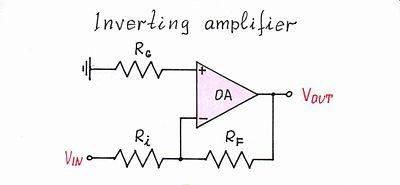

I am working with Pspice student verison 9.1. Is there any simply way i can find out the input and output resistance in pspice?
Hand-drawn circuit schematic titled Inverting amplifier: an op-amp with inputs labelled + and -, a resistor Rg from ground to the + input, Ri from VIN to the - input, and feedback resistor RF from the output VOUT back to the - input.
basiclly my opamp is same as this without Rg resistor
Thank you
I don't use pspice, but you can look at the circuit and immediately see the input impedance is Ri and the output impedance is zero.

Using this model, it may be possible to draw out the subcircuit and solve for input resistance.
Alternatively, you could attempt to run a simulation and divide input voltage by input current.
