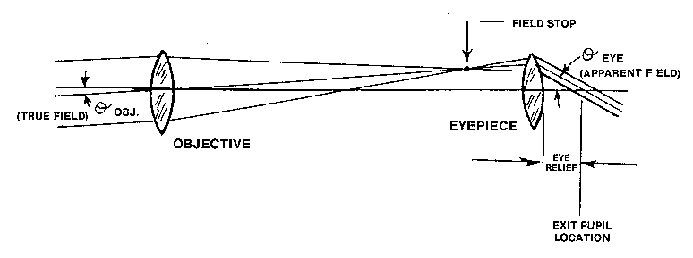

My next question is how eyepieces make images. I guess they have to duplicate the angles of all light rays if the object were that many times closer, and work back from there.
I don't understand why refractors would use two convex lenses (Plossl) past the focal point, instead of a concave lens before it, and get the upright image with less glass. Galileo used the concave lens, but with a much reduced apparent field of view. Since a Plossl takes divergent light, and makes it convergent again, I don't know why a concave lens can't take convergent light before the focus, and change it more slightly to give the same desired convergent effect. I wonder if Galileo just did not optimize his eyepiece, and why others have not improved on it.
Placing the concave lens before the focal point would mean slower optics could be used in the same total distance, and no erecting prisms would be needed, combining to mean less chromatic aberration. And less total glass.
Now if the rays coming out the exit pupil are supposed to be divergent, I could see why people would want to use the convex lenses after the focus. I could also see how the concave lens would not be powerful enough to do enough bending.
See below: (This image shows a refracting telescope, but the principles are identical for a reflecting telescope)
In the image above, the lines represent rays, or light coming in. These rays are on the optical axis and coming from "infinity", which just means that the object that emitted them is so far away that we can approximate it as if it were at infinity and there is no divergence of the rays.
Now, look what happens to the rays when passing through the objective. (Lens in a refracting telescope or mirror in a reflecting.) They are focused down to a spot but then begin to diverge before encountering the eyepiece. The eyepieces job is to take this diverging beam of light and re-focus it back to infinity. It does this because your eye is like a small telescope. Light enters through the pupil and is focused down to a spot on the retina which allows you to see. If the light was NOT re-focused to infinity your eye would not be able to focus the diverging cone very well, nor would you have any magnification.
Now, in this image, the light is coming form an object OFF the optical axis. Notice that the light from off axis exits the eyepiece at a GREATER angle than it entered the telescope objective. THIS is how magnification happens. The eyepiece collimates the light (makes it parallel) and increases the angle. Higher magnification eyepieces increase this angle more than lower magnification eyepieces.
This website explains it: http://scitechantiques.com/Galileo-...he_bottom_line:_Looking_through_the_telescope
They are not supposed to be divergent. This would make it difficult if not impossible for your eye to bring the image into focus.

Those are the best pictures I've seen yet. Thank you. I see, so in addition to have a shorter focal length than the objective for magnification, the eyepiece has a lower f# too, so the lens is large enough to accommodate off axis rays.
It makes sense that if a galaxy is far away, rays coming from each point would be parallel both before and after magnification, as shown in that picture. And the light from the exit pupil is convergent because the eye reads everything upside down on the large spherical retina, which the brain corrects.
And Galileo picked the upright image telescope despite its extremely small field of view because he was selling them to people for terrestrial use.
Well, it doesn't have to have a lower f-ratio. It's a trade off between the cost of more glass, size of the eyepiece, aberrations, and a bunch of other stuff.
The rays in each light bundle aren't convergent, the bundles merely intersect each other just like they do coming into your eye normally. Except upside/reversed usually thanks to the telescope.
The other arrangement I considered was to replace Galileo's concave lens with a convex in the same position, before the objective's focal point, shortening the total system focal length, so that convergent rays send an upright image with the wide angle view. However, I suspect that the eyepiece lens would not be capable of focusing the light in that arrangement, since it is not coming from its focal plane. It would be nice if that did work.
A convex lens would not be usable as an eyepiece if you put it before the focal point of the telescope. This is because the light coming into the eyepiece would then be converging, not diverging, and to get it parallel again you would need a concave lens.
