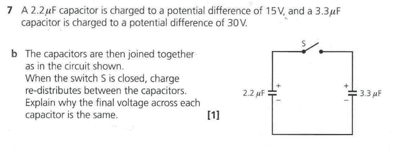

We are shown a circuit diagram as in attachement
It shows an open switch and two capacitors (both of which have been charged fully in previous experiments
Question: The capacitors are joined as shown in the circuit. When switch S is closed the voltage across both capacitors is the same. Why?
The answer says: they are in parallel
Surely this is wrong? They are in series, no?
As the charge can only follow one path it must be series, right?

When two components are in parallel they have the same voltage across them, and when they are in series they have the same current through them. So actually, they are both in series and in parallel. I.e. for a circuit this simple there is no difference between series and parallel.

surely as the capacitance of the two is different the p.d cannot be the same
would you agree though they are in series...
Yes, but that is a temporary artifact of the initial conditions and is irrelevant to whether they are in series are parallel.

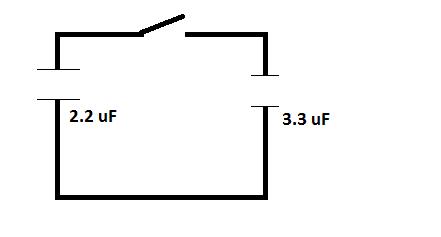

Here is the direct question
I realize I may not have been so clear
jsmith613 said:
I don't understand why they would acquire the same p.d
They must acquire the same p.d. A wire has the same potential everywhere, that is the basic purpose of a wire. So the top wire is one potential and the bottom wire is another potential. So there is the same potential between every pair of points between the top and bottom wires, including across each capacitor. That is why parallel components always have the same voltage across them, the wires constrain it to be that way.
jsmith613 said:
note: they both store the same charge as they are in series...Q=CV therefore V cannot be the same for the two components
They do not store the same charge. Being in series means that they have the same current go through them, which means that the change in the charge is the same. That is not at all the same as having the same charge unless they both start uncharged or with the same charge.

I think this makes sense...however, if they were on the SAME side of the wire (i.e looked like this)
______
C
C
______
(i cannot do the last side...C = capacitor)
Would the potential across each capacitor be different now because they have different capacitance valeus or would they still be the saem. If so, why?

They would still be the same. Why would they be different? You haven't changed the circuit any, just drawn it differently. They still have a wire connecting one side and another wire connecting the other sides and so all of my description above still applies exactly the same.
