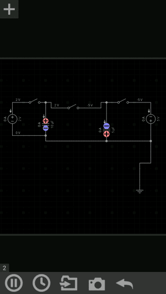

What are these pictures about?

I don't think so. If Q1 is greater, then only Vxf>Vyf. You can see it here.

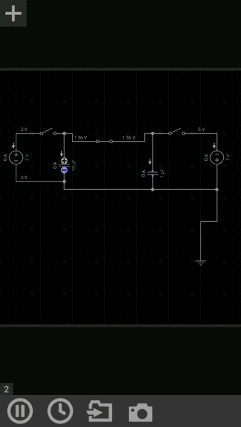

See #37. The polarity of 10uF has changed. If Q1 is more, it will retain its polarity.
  • #40
If Q1 is greater, Vxf>Vyf. In #37, Q1(charge on 10uF)is less than Q2(charge on 5uF). Hence, polarity of C1(10uF) changed, making Vxf<Vyf.

I am unable to comprehend those pictures in post #37.
It is a simulation result. It is an example of the case 3 in that video. In that circuit, Q1(charge on 10uF) is less than Q2(charge on 5uF) but initially Vx>Vy. When the middle switch is closed, it becomes the case 3. You can see the polarity of the 10uF reversed in the steady state, making Vx<Vy.
