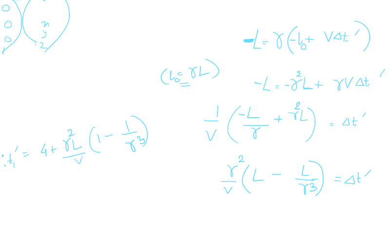

Ok, so I'm totally confused now. If I use the time transformation, I arrive at-
If I use the space transformation equation, I arrive at a different answer (which I posted just some time ago). Why is this happening? I don't seem to notice any mistake in any of the approaches, and I'm thoroughly confused.

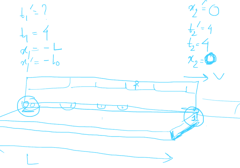

View attachment 288549View attachment 288552
I've taken the coordinates for the front end coinciding with clock 1 to be-
a) (0,4) for both the frames
and the coordinates for the rear end coinciding with clock 2 to be-
a) (-l_o,t1') for the train's frame
b) (-L,4) for the platform frame
Using these coordinates and applying the Lorentz transformations, I arrive at this result, as shown in the pics. Is this correct?
Ok, I panicked here and made a calculation mistake, it does turn out to be ##\gamma vL/c^{2}## using the space transformation as well.

That's right for part c). Did you notice that part b) was just the lack of synchronization of platform clocks in the train frame?

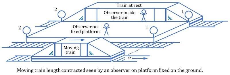

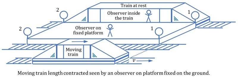

This is how I understand the problem. The two clocks on the left are synchronized, just as the two clocks on the right.
The train is longer than the platform. So, that's not right.

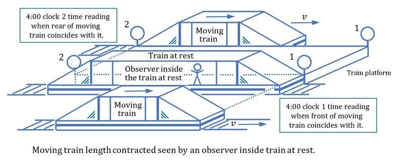

I made an isometric view and not a side view. If only you will look carefully, you will see that the front end of the train coincides with the right edge of the platform while the rear end with that of the left edge. I made the distance between the two clocks on the platform equal to the length of the train at rest. The observer inside the moving train will not notice any change in the length of the train but he will see a decrease in the distance between clocks 1 and 2. Here is another illustration of the same problem, also in isometric view:

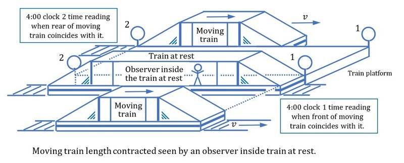

It still looks wrong to me. The rest length of the train is greater than the rest length of the platform.
Oh, but isn't the rest length of the train slightly greater than that of the platform in the isometric view in this attachment? I might be wrong.

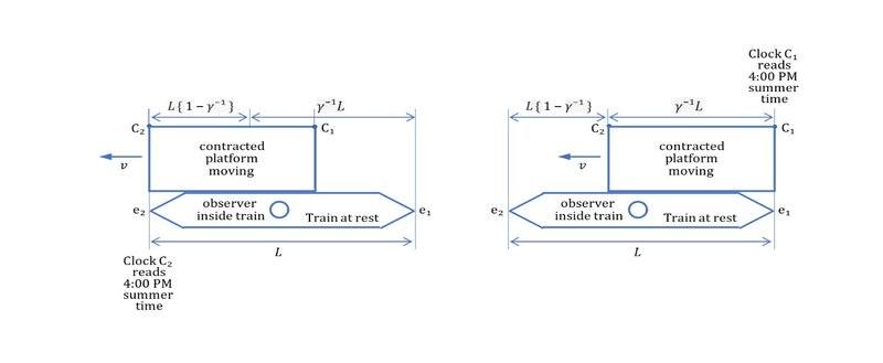

I don't see how you could that sketch to help solve the problem. On the other hand, you definitely can use my diagram to solve the problem. Despite the lack of artistry!
When two objects having the same sizes are drawn in perspective, the one in front appears a little bigger than the one at the back in order to show depth of visual perception. I drew the stationary train in front of the platform, so naturally the train should appear a little larger than the slightly smaller platform behind it. A drawing of a flat surface made seen from the top, just like what you did, cannot show depth properly. Drawings are just visual representations and they do not determine the values of the quantities that must be used in the computations.
PhysicsTruth said:
Sure, hand drawn diagrams on a piece of paper are way better on any day!
Yes, but the critical things in the train frame are:
1) The platform is (much) shorter than the train. Assuming ##v## is large.
2) Clock C2 lags behind clock C1.
That's what you needed to recognise to solve the problem.
If you want to use Lorentz Transformation, a diagram like that is still useful to establish the events you are interested in. For example, I would take C1 reading 04:00 as the common origin. (Note that that defines a unique spacetime point, which we take as the origin). The second event: clock C2 reading 04:00 has coordinates ##(t = 0, x = -L)## in the platform frame. Notice the way I dissociated the coordinates from the actual clock readings.
