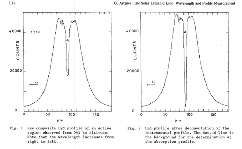

A few questions about the solar Lyman Alpha profile as presented here.
1) This is from a 1978 study - are there more recent (higher resolution) profiles ?
2) The scale at the bottom is confusing - how does it relate to a wavelength scale ?
3) Where in the profile is the actual Lyman alpha line measured or is it obtained statistically ?
4) Why twin peaks and are these replicated in Lyman beta, delta etc ?
5) Is there any significance to the peak to peak measure (about 33 picometers as I see it) ? Spacing between Lyman Alpha (H) and Lyman Alpha (Deuterium) is of the same order of magnitude so I wondered if there was any connection.
Any answers would be greatly appreciated.

(1) Should be lots of measurements of the line. These measurements will be part of a bigger picture, though, like the article you link to -- they are using the line to infer other information. c.f. http://iopscience.iop.org/0004-637X/488/2/760/fulltext/fg3.gif which comes from: http://iopscience.iop.org/0004-637X/488/2/760/fulltext/36121.text.html#fg11
(2) I have not seen this scale used. It may be something unique to astronomy, or idiosyncratic to a particular instrument.
(3) The profile is the emission line from a source of Lyman alpha radiation. The dip is the absorption of the center part of the line.
(4) The Lyman alpha "line" is split due to the presence of two slightly different energy upper states. The ground state is 2S_1/2, while the upper state can be 2P_1/2 or 2P_3/2. The 1/2 or 3/2 label is the total angular momentum (spin plus orbital angular momentum) of the upper state. http://en.wikipedia.org/wiki/Lyman-alpha_line. At first, I thought that this might be the origin of the splitting. But it looks like this is due to D, which is kind of a surprise to me, since D is not very abundant.
(5) http://iopscience.iop.org/0004-637X/488/2/760/fulltext/36121.text.html#fg11 claims that the small feature is due to the same transition in Deuterium. The earlier paper appeared to not know what the other peak was, which is kind of surprising, too.

Here is a graphic where I line up the peaks with measurement dividers (blue dotted lines) set at 33 picometers. Is it just co-incidence that the amount the peaks are separated by just happens to be (within measurement/resolution constraints) the calculated wavelength difference between Hydrogen and Deuterium Lyman Alpha lines ?
With apologies to Mr Artzner - hope he will forgive me using his Lyman Alpha profile to illustrate the point.
Yes, that is a coincidence. I suspect the deep narrow absorption in the center is due to neutral hydrogen in the vicinity of Earth (the "geocorona", I'm not really sure why it is there), but the location of the peaks probably has nothing to do with that deep narrow absorption. It is natural for emission lines of resonance lines to have two peaks like that, even when it is only one line, because light near line center has a tough time escaping-- instead, it tends to shift frequency as it scatters around, and these small random shifts (called "Doppler diffusion") allow the photons to escape better when they get a bit away from line center, where the mean-free-paths are longer.
More technically, the reason you see this in resonance lines is that the lower level is a ground state, so is very sharp, and this means that once a photon gets to frequencies well away from line center, where the mean-free-paths are large, they tend to stay at those frequencies, which creates those two peaks. If the lower level was not sharp, every time the photon scattered its frequency would be randomized, and then the escape advantages of being away from line center are exactly compensated by the reduced chance of being emitted away from line center, so the line shape is set by other factors.

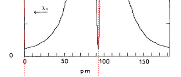

Re the original post I am still not clear as to the following:
1) The scale being used. Can someone please help me locate on which precise division we can find 1215 Angstrom ( I guessed corresponding to 160 pm). Or is that not how it works? Alternatively does anyone know the precise wavelength corresponding to 0 on the scale ? I would also assume that for really accurate measurement we need to work not with pixels (as I have been doing) but with the precise measurement gradation of the spectrometer used (0.834 pm).
2) Where precisely the measurement of the Lyman Alpha line is made ? (I guessed at the deepest part of the absorption dip).
I think I can now answer my own questions above just for the sake of closure.
1) Since the Lyman Alpha line lies between 1215.6 and 1215.7 Angstroms, I think we can safely say that 100 pm marked on Artzner's scale corresponds to 1215.6 Angstrom and that since wavelength is increasing from right to left, the zero of the scale corresponds to 1216.6 Angstrom.
2) Starting at 1216.6 Angstrom I drew up a table of wavelength values decreasing each time by the step value of 0.834 pm. I identified the deepest portion of the geocoronal absorption dip at the 112th step - that is at 1216.6 - 0.00834 x 112 = 1215.66592 Angstrom. And I presume that is what would correspond to Artzner's (unstated) measurement of the Lyman Alpha line. Perhaps that should rather be given as 1215.66592 A +- 0.00834 A.

If you read the article you linked to, it's all explained there : the sharp central absorption feature A (and thus the twin peaks) are due to hydrogen in the Earth's atmosphere (geocorona), the small absorption feature B at the top of the left peak is speculated to be due to the absorption by the interstellar wind (which is shifted from the center as the Earth moves with respect to it).
The main query I still have is exactly what value is used for the measured Lyman Alpha wavelength. How do we get from the geo coronal absorption maximum (or should I say minimum) at 1215.66592 A (if my above interpretation of Artzner's scale is correct) to 1215.6701 A which seems to be the currently accepted value? Also why does this value differ (slightly but significantly) from the wavelength (1215.67312 A) which one can calculate based on Parthey's very careful measurement of the Hydrogen 1s-2s transition at 2 466 061 413 187 035 (10) Hz.
The Lyman alpha line has several sublevels due to various relativistic corrections inside the H atom, so you have to distinguish the line center that you would measure as a combination of all those sublevels, versus calculations of the transition energies of individual sublevels. Also, the 1s-2s transition is not Lyman alpha at all, that's a forbidden line that won't contribute anything significant here. The normal Lyman alpha line is a 1s-2p transition, obeying the selection rule.

I think I perhaps have an explanation for my own query here. If in Artzner's measurement intensity/irradiance 'samples' were taken at 0.834 pico meter steps, then the corresponding frequency values would perhaps be taken at the centre (rather than at the end) of each step. Accordingly I need to adjust my formula slightly - at the 112th step the frequency is 1216.6 - (112 x 0.00834 - 0.00417) = 1215.67009 A. Possibly that may be the origin of the current Lyman Alpha measurement of 1215.6701 A. The bracketed part of the calculation amounts to 92.991 ≈ 93 pico meters from the scale zero and I show this measurement in the following screen snap.If this is the case, then Artzner's 'raw measurement' is 1215.6701 +- 0.00417 A or 1215.66592 < λ < 1215.67426 A and that range would obviously encompass 1215.6731 A.
But this is a 1978 measurement - hasn't there been any subsequent measurement at higher resolution than Artzner's 0.834 pm steps ?
I've just noticed something else here - is it by design, co-incidence or just incredibly accurate measurement that the upper and lower limits of the measurement above almost coincide with the doublet wavelengths at 1215.668 A and 1215.674 A ? (The numbers I give here are Ritz wavelengths from the NIST spectral database).

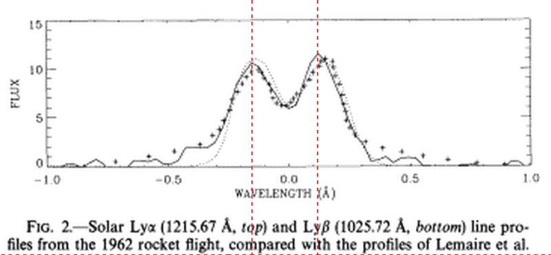

Here is another interesting co-incidence. The diagram below is a Lyman Beta profile - the best I could find. Unfortunately there does not seem to be any profile at the same or better resolution than Artzner's Lyman Alpha profile. All the same I am here setting my dividers at 27.9 pm which I calculate as the separation between Lyman Beta (H) and Lyman Beta (D). Well I would say we need a higher resolution profile to check this out properly. Please click the link above for source material.
What do you mean by 'Lyman Beta (H) and Lyman Beta (D)' These two peaks here a caused by self-reversal/abosrption of the line in the solar atmosphere (geocoronal absorption can be neglected for Lyman Beta). The frequency/wavlength shift for deuterium is only about 0.03pm ( http://en.wikipedia.org/wiki/Deuterium ) so completely negligible here. Also, the abundance of deuterium is only of the order of 10-4 of that of hydrogen, so it practically not contribute to the measured intensity anyway.( http://adsabs.harvard.edu/full/1962Obs...82..106R )
