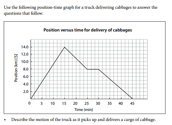

1.[/B]
Position versus time graph for a truck delivering cabbages: position in km (S) against time in min from 0 to 45, rising to 14.0 km at 15 min, falling to 8.0 km by 25 min, flat until 30 min, then falling to 0 at 45 min.

1.
The truck traveled 14.0 km (South) in 15 min. The truck continued another 6 km at a slower pace over 10 min, and then stayed at this location for 5 min. The truck continued on at a constant speed for another 8 km towards the destination, taking 15 min for this portion of its journey.
Are you sure it 'continued' in the same direction? What does the fact that the North-South coordinate is reducing over this 10 minutes tell us?
Towards the destination? What do you mean by the destination? A place to deliver cabbages, or the home depot?
ok sorry about that :P
"Are you sure it 'continued' in the same direction? What does the fact that the North-South coordinate is reducing over this 10 minutes tell us?"
is the truck now traveling in an east-south direction?
We are given no information about its East-West coordinates. Only the North-South coordinates are given. Hence we should assume that it is traveling only along a road that runs North-South.
so was the truck traveling North initially, but then began to travel towards the south direction?
No, traveling South first, because the coordinate given is the km to the South. THen turns and travels North later.
Nearly right. That might not be what you intended to say.
so is this how it goes:
The truck traveled 14.0 km (South) in 15 min. The truck then traveled another 6 km North at a slower pace over 10 min, staying at this location for 5 min. The truck continued on at a constant speed for another 8 km towards the destination, taking 15 min for this portion of its journey.
also am i right that the truck continues at a constant speed?
Yes, but as has already been suggested you should state the speeds.

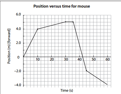

Line graph titled Position versus time for mouse, plotting position in metres forward against time in seconds from 0 to 60 s, with a piecewise-linear path rising to about 4 m at 10 s, reaching 5 m near 30 s, staying flat to 35 s, then falling to about -2 m at 44 s and to -4 m at 60 s.
Printed text problem describing a mouse's movement: it moves 4 m forward in 10 s, another 1 m forward over 30 s, stays 5 s, returns 2 m past its nest in 10 s, then moves 2 m past its nest in 15 s.
  • Graph of position (m, forward) against time (s) for a mouse: a line rises from 0 to 4.0 m by 10 s, climbs gently to 5.0 m by 30 s, holds near 5.0 m until about 35 s, then falls steeply to -2.0 m near 44 s and continues down to about -3.9 m at 60 s.
