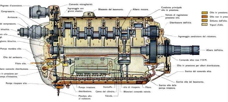

Looks like the Germans did this before WW2 with an Inverted V engine. Mercedes again, I copied some post from above discussion.
Oil is pumped under pressure to the crankcase and runs by gravity down a path between the cylinders into the camshaft covers where there are camshaft driven pumps to return out to the header tank. I'm not certain of this but, in regard to the collection of oil in the cylinder bores, I would suggest that it probably does but that, when the engine is running, the oil is constantly being splashed back up into the crank case to eventually run down to the camshaft covers.
The inverted engine did pose problems with oil supply and consumption. The British sent a team to Germany immediately after WW2 to investigate the German engines and speak to German engineers. The British team comprised men from the Ministry of Aircrat Production and all the British aero engine manufacturers (including Armstrong Siddeley Motors, Bristol Aero Co., D. Napier & Son and of course Rolls Royce). They produced a report, 'Comments on Visit to Germany, July 24th 1945 to August 12th 1945'. In it they recorded that Daimler Benz engineers would have preferred an upright 'V', but the inverted layout was a requirement of the RLM (actually it predated the RLM, back to 1928).
They made the point that it was very difficult to get even oil consumption as the rotation of the crankshaft caused one bank to get more oil than the other. It's why the compression ratio is lower on one bank than the other.
The same issue technically applies to many radial cylinders but the speed the pistons move ensures that the vast majority of the oil gets thrown up and finding its way into the sumps while the engine is running.
Once the engine stops naturally relatively large amounts of oil accumulate in the down facing cylinders on radials so it is essential that the engine is pulled through before starting to ensure there are no cylinders with a hydraulic lock.
  • Cutaway diagram of a V12 engine with Italian labels showing the oil circuit, including crankshaft, oil pump, filter, sump and pressure valves, with a colour key for oil under pressure, non-pressurised oil, foam and oil vapour.

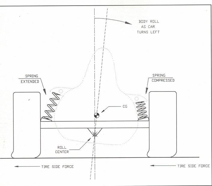

I did some research and here are the required modifications-need to tool up new bell housing with transmission mount holes re-drilled. Shift linkage and clutch should be OK. Invert engine and make new engine mounts on chassis and engine. chances are you have a front motor plate so pretty easy. New to go reverse rotation and get reverse starter and camshaft and gears. Need to rework rear end flip it 180 degrees and weld on new spring perches. Need to fabricate dry sump system. need to make new headers. Need new intake system. Need to rethink ignition with crank sensor not distributor. I would go with electric water pump. Disadvantages - Crankshaft of engine and center line as well as Transmission and drive shaft ( approx. 50 lbs of mass) 6 inch higher than before. Advantages - we have reverse rotation assisting the cornering by planting force on left front wheel turning cornering. We have the 95% of the entire engine mass of 400 lbs. located below the crank center line. Only one half of the crankshaft and the oil pan are over the center line. Previously we had 400 pounds above the crankshaft center line. That is half the crankshaft, half of the connecting rods, all pistons and wrist pins and Cylinder heads were 16 inch above the pavement to 34" above pavement ( cylinder heads) the heads now are only 4" above pavement. this does not include headers and intake. A little later i will work up how this impact s on cornering but intuitively this could be very significant!
Here is the major benefit- From Circle Track Suspension by Forbes Aird
When the COG is under the RC the body rolls to assist in the corner, exactly opposite of what we now have.
