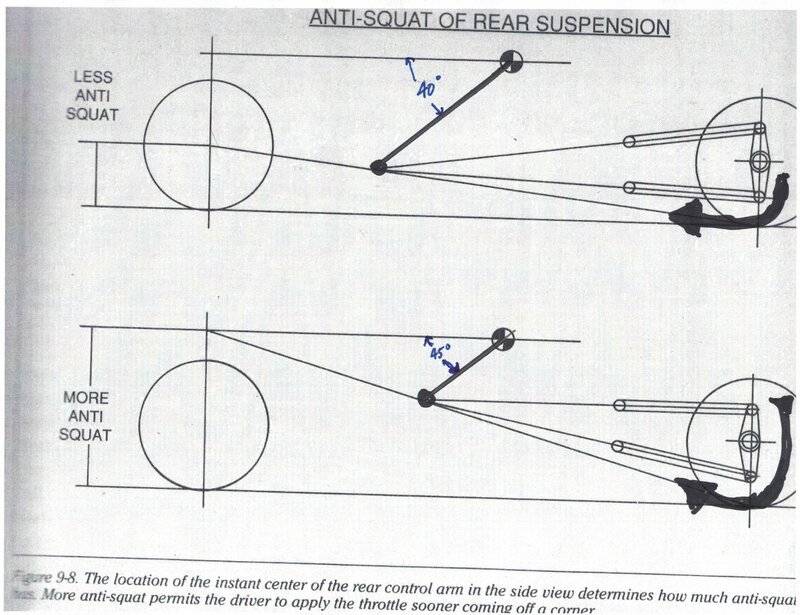

Anti Squat - revisited
Personally , I am not into ANTI anything on a race car. Adding in Anti Dive, anti squat, droop limiters etc.. to a poor performing race car to keep it from pushing is at best a Band-Aid if you think about it ...you are trying to treat the problem not the cause. I am a big believer in using a cars suspension to deal with weight transfer. I don't even like roll steer but in some classes, its all you can do to make the most with a bad situation. We all know why unsprung weight is so evil. You cannot control it. So, with that line of thought, sprung weight is " good" because we can control it..right? So how best to control the weight transfer? Springs and shocks and ARB (sway bar). Remember, Too much anti squat means BRAKE HOP
Above is 10 year old statement and you can teach an old dog new tricks..I believe in roll rear steer big time now. And if your rules dictate hard spec tires, look at anti squat. Not so much on sticky tire classes.
Draw a horizontal line thru the COG parallel with the ground
On front end, draw a vertical line from the ground thru the front axle center up to horizontal COG line. Now at this point, draw a line to the rear tire contact patch.
This is the 100% anti squat line. You want your rear IC at this line or a little over it.https://www.google.com/search?clien...placement#kpvalbx=_u5OfYbeLN4aYptQPjYewuAU121
If the IC is on the line connecting the rear tire patch with a line between the CG and the front axle centerline you have 100% anti squat. If the line falls below this point you have less than 100% anti squat. Study the illustration.
Study the attached. Less anti squat means the forces are pushing toward the front of the car by pulling at the CG at a 40° angle. The plus anti squat vector pushes to lift the front end and pulling the CG thru a 45° angle.
The IC acts like a moment arm or level. It should remain in one location. The farther to the front the instant center the less the IC location will change during rear end movement up and down / sideways during cornering and acceleration. The shorter the IC distance of frt mount point to is the to rear top link mount point the dartier the car will be because the IC is moving more and makes the car feel unsteerable to the driver. In side view, the lines of constant percent anti-squat all pass through the rear tire patch. The greater the slope, the higher the percentage of anti-squat. The location of the IC is determined by the intersection of 2 lines; one drawn through the pivot points of the upper link and the other drawn through the pivot points of the lower link. When the lower link is kept horizontal (or nearly so) and IC adjustments are made with the upper link, a raising of the front of the upper link causes the intersection of the link lines to move forward and fall on a line of less percent anti-squat; a lowering of the front of the upper link causes the intersection to move backward and fall on a line of greater percent anti squat.
So, a shorter IC...UNDER THE CONDITIONS JUST DESCRIBED...would move the anti squat value closer to...or perhaps in excess of...100%. At values over 100%, the car is said to have more bite or grip.
With a longer IC, there is less anti squat and the rear of the car is seen to squat on launch. The front of the car will always rise, of course, but that visible squat at the rear is accompanied by additional rise at the front. This additional rise is the result of a low anti squat value and NOT the result of the long IC.
IC length and the COG - Remember, our goal is to use lift to counteract weight transfer and plant the rear tires with downforce on acceleration.
Let's say your IC length is directly under your C/G location. This makes lifting the front of the car relatively easy. Moving the IC forward of the C/G location makes it much harder to gain lift at the rear due to the angle between the C/G and the IC, no matter how close you are to the neutral (100%) line.
One time we had a top link that was anchored to the chassis by the drivers right foot..LLLLLoooonnngg bar. Basically that is the only benefit. Less IC migration with longer top link. Top link down hill angle is between 5 and 7 degrees. On asphalt cars with sticky tires Lower links should be level with the pavement and longer is better here too. 20 “ typical , 24” is better. Hard spec tires means you have to add angle to the lower arms. Emods with hard spec tires need more bite and 5 degree up hill is typical. More than 5 degrees will promote quick hook up but not maintain grip down the straights as well and the 5 degree is a good compromise to grip off the turn and not wear out the rear tires.Illustrations from Herb Adams book Chassis Engineering – excellent read
  • Page from a textbook titled "Rear Suspension to Provide Roll Understeer" showing top, front and side view diagrams of a car rear axle and suspension, with body text on anti-squat below.
  • Side-view diagram titled ANTI-SQUAT OF REAR SUSPENSION comparing two rear control arm instant center locations: less anti squat (top, control arm angle 40 degrees) and more anti squat (bottom, angle 45 degrees).
  • Chart 9-1 table of rear weight transfer values in pounds, comparing left and right rear tires without and with anti-squat, with rows for static weight, cornering, acceleration, anti-squat effect, traction and totals.
If we work thur the Figure 9-8 we see the same vector made up of horizontal and vertical forces like on the dog chain below. Assume the tires project 100 pounds force. Disregard effects of anti squat on downforce load for the purpose of understanding. More anti squat acting on 45° angle means Vert. Force of 71 lbs and Hor. Force of 71 lbs. With the forces acting thru the 40° less anti squat vectors we have Vert. Force of 64 lbs. and Horz. Force of 76 lbs. ​
Example of way over 100% anti squat is a drag car doing a wheelie off the christmas tree. Anti squat trys to lift the front of the race car​

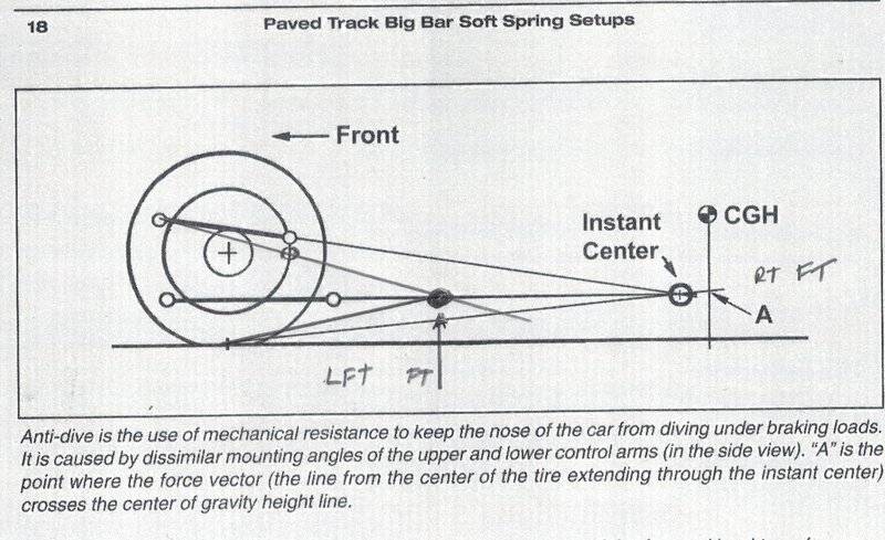

Steve Smith in his great book Paved Track Big Bar Soft Sprig Setups outlined the whole thing. Buy the book.
He states you need Anti-dive which is 3 1/2 to 4 ° on right front and 1 1/2 to 2 ° on left front. I can almost guarantee you that you are running an after market chassis like Howe or Port City, the lower A-arm mounts are parallel to the track (same height front and back).
You need the right front upper A-arm mount point on the front 1/2" higher than the rear (HEIGHT FROM THE GROUND)
you need the left upper A-arm mounts so that the front mount is 1/4" higher than the rear
The left has less anti-dive than the right so forward load transfer compresses the left front corner easier than the right and it does it quicker, helps place weight on the left front tire at corner entry. Shock rebound at left front and stiffer right rear spring help hold down the left front. If we use a right front compression shock it holds cross weight and we have a push. Note in photo the lever distance of IC to COG.
My opinion is that a mechanical means to handle momentum (aka weight transfer) is far better than high dollar shocks and labor intensive spring swaps. This is why we need to tackle this first then fix the roll center location.
  • Side-view diagram of a race car front suspension showing the instant center, center of gravity height line (CGH), and point A where the force vector crosses it, with labels LFT, RT FT and Front.
Measured the Port City chassis. As found the front top A-Arm mounts were taller in the rear than the front (mount points relative to ground) exactly what we do not want for anti-dive. Fixed these and roll center now off big time as expected. Front roll center now 2.1" height and offset 14.2" to the left of centerline.
After playing with the Circle Track Analyzer the new Roll Center is 2.4" height and 2.9" offset to the right and looks pretty good in 2" dive, 1/2° roll. Got this by adding height to the ball joints.

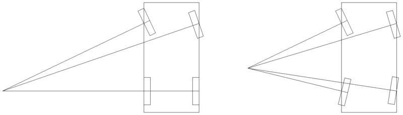

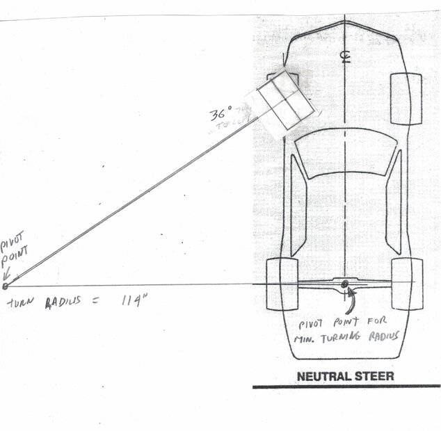

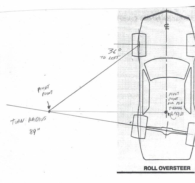

Why we need rear roll over steer
Note the left figure below is standard Port city set up with rear end square to the car centerline.
The right figure is a rear steer car and note the turning radius is a lot shorter axis.
Roll over steer allows the car to roll around a corner without breaking traction. Breaking traction occurs when forward grip stops and the tire goes into shear sliding sideways. This is one reason you use Stagger and it helps to a point. But at some point all locked rear ends lose traction and you have to hit the brakes or spin out. With no rear roll steer the tire has to break traction to turn. When you have roll over steer the rear end steers the car and no side slip is required. Forward traction is maintained and the rear end is steered.
When I see two famous car book authors Steve Smith ( his illustrations and my sketched up mess) and Herb Adams ( his scan of page in Chassis Engineering) say in print that this works, I have to believe it. Even more than that, just look at a dirt late model race. You can see the wheelbase shrink on the drivers side with body roll.
My sketched up illustrations are very simplified. I should draw in the 26° axle angle of the right side wheel but you get the idea. Shorter turn radius and pivot turn point a lot closer to the COG means better turning relative to the competition.
  • Two top-down schematic diagrams of a car chassis with rear wheels angled, showing turning arcs; left shows rear wheels square to centerline, right shows rear wheels steered inward, with turn centers drawn as lines converging at a point.
  • Hand-drawn top-down diagram labelled Neutral Steer showing a car with a 36° tire angle, a pivot point on the rear axle line, and a turn radius of 114 inches.
  • Hand-sketched top-down diagram of a car labelled ROLL OVERSTEER, showing a 36 degree angle to the left, a pivot point and a turn radius of 89 inches.
  • Diagram of a car rear axle steering setup: a circle representing a turning path, with LEFT ARM and RIGHT ARM labels and arms drawn as lines from the circle to the axle.

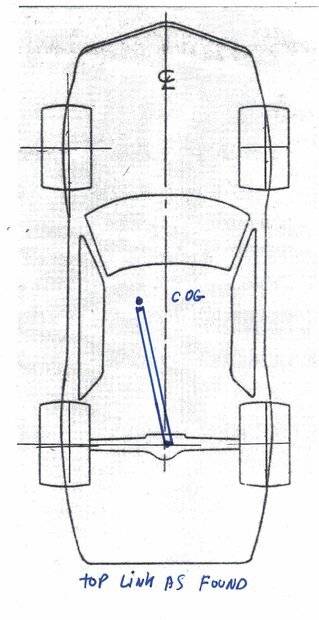

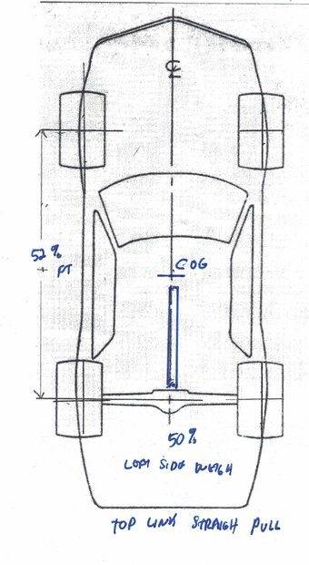

We found out the top link mounting point on the rear end was same setting as from the Port City factory. We are running 58% left side weight so the distance from right rear tire centerline to tip link mount was off 6". since we can only use solid links , no springer top link or spring trailing arms, the mount location is vital to good tire hook up. As found distance from rt rear CL was 32" on 66" rear track width. So 58% left side weight means the mount point is 66 x .58 = 38.25" and changing it means both rear tires are loading the same.
  • Hand-drawn top-view sketch of a race car chassis showing four wheels, a centreline, COG marker, and a 52% PT dimension with 50% and 'TOP LINK STRAIGHT PULL' and 'COMP SIDE WEIGHT' labels in blue.
  • Hand-marked top-view sketch of a race car chassis with the centerline dashed, four wheels, and a blue line from the COG dot to the rear left-side mount, labeled TOP LINK AS FOUND.
  • Hand-drawn top-view sketch of a race car chassis with the centre of gravity marked COG and a blue vertical line labelled PROPER TOP LINK MOUNTING running from the rear axle toward the centreline.

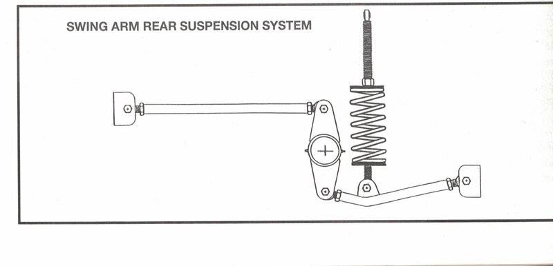

Hi RM I think with the top link or pull bar setup, it acts similar to a torque arm. On a TA rear, if you have live birdcages, the balanced load setup would have the front mount point of the TA on a line starting at a point where a line projected back from the CG, square to the rear, meets the front to back center of the rear. The other point defining the line is a point on a transverse line from the CG, to the right with the distance from that point to the CG being equal to the distance from the CG to center of the rear, times the gear ratio of the rear. Any mount point on that line should load the tires proportionally to the left side percentage. The difference with the pull bar is the upward vector at the front would not be the same and would vary with the angle and the vertical distance between the pull bar mount point on the rear, to the lower trailing arm mount points. I think a drawing would explain this better, but I don't have time right now.
Sorry, there is a mistake in the previous post. The transverse or lateral distance should be the distance from the CG to the axle centerline, times 1 over the gear ratio. lateral distance = CG to rear / gear ratio
Ranger Mike,
I was reading through your posts on rear steer and can say I am with you on it having a positive effect on cornering. We experimented with it late last season and found good results. What I am now curious about is when making the adjustments for rear steer is it better to make the adjustments at the rear end or at the chassis. In other words does raising the front of the trailing arms (chassis mounts) have a different effect than raising or lowering the rear of the trailing arms (rear mounts)
Thanks
i have not studied the benefit/drawback to adjusting on front chassis mount vs rear end mounts. If the rules let you adjust in rear roll steer then go with the easiest accessible adjustment. Now if the rules are more stringent, and not clearly telling you that you can do this, (Smokey Yunick) then you have to be a little bit clandestine in dialing in this advantage. You can buy offset bushings. You can grind in a slot to give this adjustment and the large washer should cover it up. Depends. But having the ability to have a wheelbase change is a definite winner!
Mike,
I am working with a suspension that has a modified watts link to located the rear axle in the car longitudinally (sprint car) and no one in the business can tell me how to locate the instant center. As i understand it with this style of suspension the IC move drastically as the suspension travels. I have looked for programs to find it but have come up empty. Any insight on have to find the IC would be greatly appreciated
Thanks
Why you worried about the IC ?? Look at the rear roll center!
The part about the IC moving drastically , to me, does not matter. The RC will be more stable than the Panhard bar setup.
The Roll Center of the Watts linkage is the center point mount of the Center Link. This set up eliminates the slight lateral movement that the panhard bar has. The watts is a better deal for straight line control from a design standpoint. James Watt invented this when he made the first practical steam engine.
It is a more complex set up (and heavier) because the main pivot point is the roll center height and is not easily changed.

cearnold23,
On a true watts link, with equal length rods, there is no IC because the center pivot is a straight line motion that is perpendicular to the rods when they are positioned parallel to each other.
that is NOT a Watts linkage. It is a swing arm suspension. Sometimes called a Z link. As far as this photo shows me. I can not see all the workings of it but appears to be a variation of the swing arm with torsion bar.
I suggest you buy I.M.C.A. Modified Racing Technology from Steve Smith Autosports. he has good intial settings outlined in it.
  • Line drawing titled SWING ARM REAR SUSPENSION SYSTEM showing a horizontal link bar, a pivoting swing arm with a central circular bearing, a coil spring over a shock absorber on a bracket, and a lower angled link bar, all attached to mounting plates.

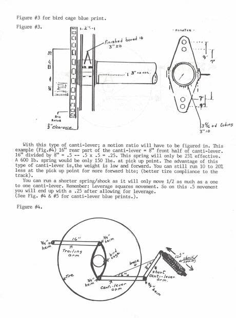

Without seeing your set up, another guess is the Cantilever design. This is from Short Track Chassis Set-up by Duke Southard
  • Scanned typed page titled Cantilever Rear Suspension, with two line drawings: Figure 1 shows a coil-over spring and shock on a cantilever arm at a wheel, and Figure 2 shows a rear axle with springs and shocks mounted on a cantilever arrangement.
  • Figure #3 and Figure #4 from a race car cantilever suspension guide: line drawings of a wheel hub with a finished bored ID and cantilever arm geometry, with labeled lengths such as 16 inch, 8 inch and 12.5 inch.
  • Hand-drawn figure #5 showing a race car suspension layout with a circular tire, a spring/shock unit, a vertical cantilever arm, a horizontal cantilever arm, a trailing arm, a brace, a bird cage and a frame mount, with dimensions of 18", 16", 16" and 3/4" heim joints.
