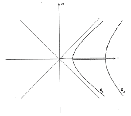

In this problem you have an observer in the rocket who is located at a point with parameter X1. His wristwatch measures his proper time. You want to know the elapse of this observer's proper time (wristwatch time) between the event where the light pulse is sent out by this observer and the event where the pulse returns to this observer. If you could determine the coordinate time t of these two events, then you can use the equation α1t/c = sinh(α1τ/c) to determine the corresponding proper time for each event for this observer. The subscript 1 on the α emphasizes that this observer has acceleration associated with parameter X1.
jack476 said:
The point at parameter X2 appears to move to an observer along the trajectory x2 - (ct)2 = X22 and the pulse of light along the trajectory x = X1 + ct. By substituting x, we get ct = (X22 - X12)/2X1, and then with the third relation above we get αt/c = (X22 - X12)/2X1X2. Then with the second relation, we get τ = (c/α)arcsinh((X22 - X12)/2X1X2)
This gives the proper time of the arrival of the pulse at the reflection point on the worldline X2 for an observer moving with the parameter X2. But that's not what you need. You need the proper times for the emission and return events for the observer with parameter X1.
Rindler's hint is to choose the emission and return events "symmetrically" on curve X1 in the figure below such that the reflection event (on the curve X2) occurs when the rocket is at rest in the figure.
