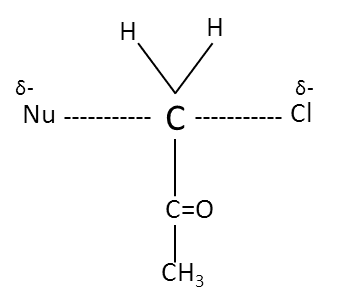

The decreasing order of rate of SN2 reaction is:
a)CH3-Cl
b)CH3-CO-CH2-Cl
I have been trying hard to find the reason why i am wrong. It's obvious that less hindrance, more reactivity towards SN2. Using the same logic, the answer should be a>b but it is b>a. Now i don't understand where i went wrong. There is more hindrance in b than a.

Well, i was thinking about the same thing. It seems like that the stability has to do with the carbonyl group attached. If i draw the transition state,
Nu is the attacking nucleophile.
You say that it has to do with the adjacent pi electron system, i don't see what it can do here. I can only think of the inductive effect which stabilizes the negative charge developing on Nu and Cl.
You will note that the transition state you have illustrated here has three groups aligned roughly equidistant in a plane and the incoming and leaving groups aligned along an axis orthogonal to that plane. This is a description of an sp2 hybridized reaction center. The adjacent pi system (C=O) can conjugate with this reaction center. How might this conjugation affect the energy of the transition state? What does delocalization do to the energy of the transition state?
BTW the difference between the rate of reaction of chloroacetone relative to methyl iodide is on the order of ten thousand.

According to excerpt I posted, Carbonyl group is an electron withdrawing group. So it seems like withdrawing electrons from electron deficient group is not a good idea, so the reaction tries to avoid this, thus the molecules goes into SN2 reaction.
Remember we started with a neutral molecule and a negatively charged nucleophile. That negative charge of the nucleophile is smeared out between approaching and leaving group. The positive charge resides wholly on the counterion of the nucleophile, which you haven't shown. In the case where a neutral molecule nucleophile approaches, the corresponding positive charge develops on the attacking nucleophile. The substrate stays remarkably neutral.
