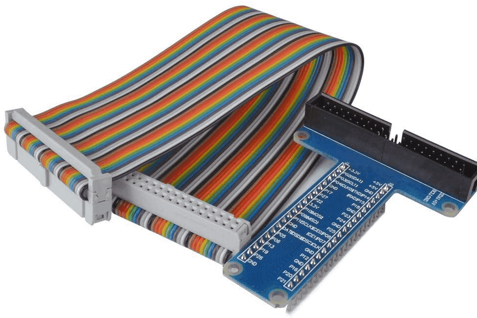

Three annoyances.
1. Some LEDs dimly light up even if their state is powered off.
2. The right half of my breadboard is busted, nothing on the right gets powered. The GPIO extension board is fine though.
The quality of this kind of stuff is variable, not surprising as it is ridiculously cheap. I have found Elegoo to be more reliable than others.
