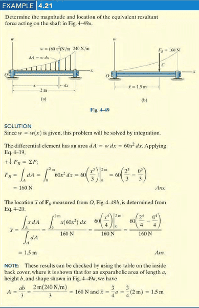

Two textbook diagrams of a horizontal shaft with a distributed load: (a) a parabolic load w = (60 x^2) N/m over 2 m, total 240 N/m at the end; (b) a resultant force F_R = 160 N at x-bar = 1.5 m, with worked integration solution for Example 4.21.

Why can't we use the NOTE method (exercise 4.21) on the exercise 4-156 ?
A = ab/3 = (10.500)/3 = 1666,66 N --> this not right
Because the location function is different. In one case is goes as ##x^2## and in the other as ##x^3##. If you do the integral in each case, you will get a different answer.
