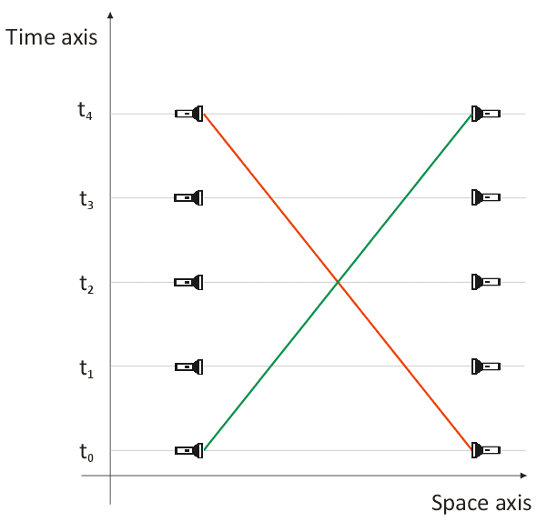

Nothing can move faster than ##c## relative to any reference frame. Thus I can have two light beams traveling at ##\pm c## and the distance between them (as measured by me) falls at ##2c##, and this is fine because nothing exceeds ##c## relative to my rest frame. However, I cannot transform into "the rest frame of one of the light beams" and measure the speed of the other, because it is not possible to define a frame where a light beam is at rest.
Euclidean geometry is the wrong tool to be using for this - you need to be using Minkowski geometry.

As @Ibix states, the separation speed as measured by an observer in the middle of two light beams going in the opposite direction would be ##2c##. (You would have to be very cautious about using this speed. I don't know if there is any physically meaningful use for it.)
Although you can not talk about the speed of one light beam in the reference frame of the other, you can imagine two objects traveling in opposite directions, each at nearly light speed from an observer in the middle. In that case, you can talk about the speed of one object in the reference frame of the other. That will never be greater than ##c##. An observer in the middle would see the total separation speed as nearly ##2c##. The reason for the difference is the distortion of the Minkowski geometry. In the Minkowski geometry, there is no such thing as a relative speed greater than ##c##

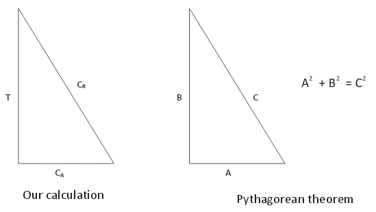

Actually does anyone know the exact speed of light?
The speed of light was measured in our world, which is limited to 3 dimensions. However the universe is much wider space, all aspects.
Let's expand the study and consider the fourth dimension as well, the time axis. It is part of the modern physics, and this was raised by Einstein, firstly.
Let say there are two torches oppositely directed to each other. One light is red and other one light is green. (Color does not relevant) Both lamps emitted a beam of light at the same time.
While one beam of light arrives to the other point, it moved in the space (x, y, and z - axles),
BUT! - In the same time it moves on the 4th axis, on the time axis as well. (t - Axis)
The measured and accepted value of the speed of light is 300,000 km/s. But what if, if this is the just apparent speed of light? The real speed is in the 4 dimensional inertial system is greater. Let say 2C.
Rename the light of speed (C) to apparent light of speed: CA=300,000 km/s
Let's install a new concept: real speed of light: CR=600,000 km/s
A2 + B2 = C2
Replace variables by our variables:
CA2 + T2 = CR2
CA2 + T2 = (2CA)2
CA2 + T2 = 4CA2
T2 = 3CA2
T = √3 CA
T = √3 * 300,000
T = 1.73 * 300,000
T = 519,000 km/s
So, the speed of anything on time axis is nearly 520,000 km/s.
The real speed of the light is 600,000 km/s and the 2 light beams relative speed is 600,000 km/s, what is equal by real light speed, which is not greater than maximum speed of the universe.
In this form, Euclidean geometry is also true and Einstein's rule is true as well.
Plus, we also calculated a hitherto unknown constant.
Yes, it's defined to be ##299792458\frac{m}{s}##
Yes, because it is now defined, in SI units, to be exactly ##299,792,458## meters per second.
The reason this is possible is that what you are calling "the speed of light" is really an inherent property of spacetime. It's not something we "measure". In "natural" units, it is just ##1##; the only reason we use a weird number like ##299,792,458## instead of ##1## is that we humans have had a weird history of developing units for things.
None of this makes any sense.

Janos Meri said:
Euclidean geometry
Specetime geometry is not Euclidean, so you can't use Pythagorean theorem. I think it would be better to spent some time reading textbooks on relativity rather than wasting your time on things that are known to be wrong :tree:
It was actually Minkowski who pointed out that Einstein's maths could be interpreted as implying a 4d structure to the universe.
The rest of what you've written, charitably, looks like you've seen but failed to understand a Minkowski diagram. You appear to be trying to apply Euclidean geometry in a situation where you need to use Minkowski geometry. I'd strongly recommend spending some time with a textbook.

And, as has been pointed out repeatedly, you are analysing this completely wrongly. You need to use Minkowski geometry, not Euclidean geometry.
Janos Meri said:
So in a four-dimensional coordinate system, the speed of light must be greater than 300,000 km/s, because the light also moves along on time axis as well.
No. In fact, the 4d analog of distance along a light path is zero (hence the alternative name "null worldline" for lightlike worldlines). And you can't define "speed" through 4d spacetime (Brian Greene notwithstanding) because time isn't a separate thing.
Janos Meri said:
The point of what I wanted to describe is (...) in a four-dimensional coordinate system, the speed of light must be greater than 300,000 km/s, because the light also moves along on time axis as well.
And we've already addresed it - it's wrong. Spacetime is not Euclidean, there is no meaningfull way to define "speed along time axis", and other things that you can find in most of the textbooks on relativity.
