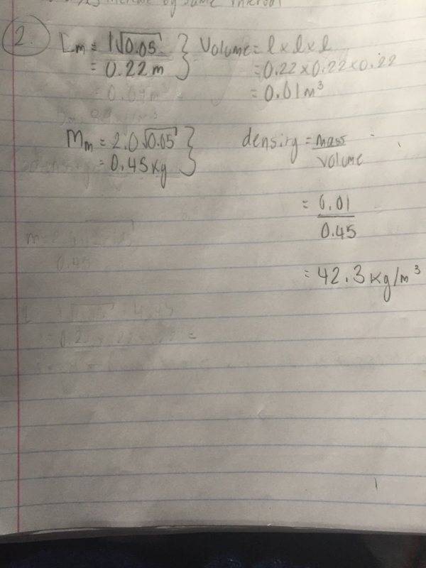

We never learned how to use these formulas, so I'm pretty much grasping for straws. I got 2.04 kg/m^3. Can anyone check my work/teach me proper methods if I'm wrong? Thanks.
Wait that's definitely wrong... Now I'm getting 42.3. Is that right?
Can you explain what you're doing?
Yes. I'll attach a picture.
I wrote the last division statement wrong (switch numerator and denominator) but yes I get 42.3 or 45 if I don't round.

Did you forget to square something?
If I can understand what you're doing, you are length contracting all three dimensions of of the cube.
Yes I think that's what I'm doing. Am I not supposed to? Is this the wrong formula?
Length contraction is only in the direction of relative motion.
So what formula should I be using to get the new volume?

You already quoted the correct formula for length contraction. By what factor has the length of the cube contracted?
This factor is also known as gamma (##\gamma##).
Okay here's the problem. The square root of 1 - (0.95c)^2 / c^2 should be 0.312. I calculated this wrong.

Is only one side length affected by length contraction or all three?
Who says the cube is moving parallel to one of its edges? But, let's assume it is, what do you think?
Yes?

There is no length contraction in directions perpendicular to the motion.

Yes, only one side is contracted.

Now one more thing I don't understand.
mm = 2 / 0.312 = 6.4 m
Lm = 1 / 0.312 = 3.2 kg
6.4 / 3.2(1)(1) = 2
Why am I still getting 2 as the answer? Does the density not change?

Can you compare your formula for length contraction to the one in the book? When length "contracts", does it get larger or smaller?
I am also concerned about your units. Your contracted length is expressed in kilograms?
So I am supposed to multiply there, not divide? Making the new length 0.312?
Making the answer 20.5?
Or is density supposed to be unchanged??

Sorry, swap kg and m there. Copied it wrong.
But the book shows Lm and Ls reversed from what I have here...
So 20.5 should be the answer? Or 2?
Go back to basics.
Moving objects appear to be shortened. Short objects have lower volume. Lower volume means higher density.
Moving objects gain relativistic mass. [Note that relativistic mass is a deprecated concept that would better be left untaught]. More mass means higher density.
Both effects call for an increased density. So an answer of 2.0 kg/m3 could not be correct.
20.5 kg/m3 matches what I get. Though you might want to consider rounding to an appropriate number of significant figures.
