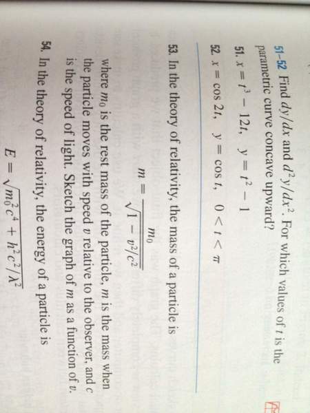

In the theory of relativity, mass of a particle is
m= m_{0}/ \sqrt{1-v^{2}/c^{2}}
m is the mass when the particle moves at v relative to the observer, and m_{0} is the rest mass.
Sketch the graph of m with respect to v.

Sketch the graph of m with respect to v. 2. Homework Equations
m = \frac{m_{0}}{\sqrt{1-v^{2}/c^{2}}}
In order to sketch the graph, I had to first (before finding the derivative and second derivative):
- Define the domain
- Find the x and y intercepts
- Find where there would be asymptotes (both vertical and horizontal)
- Check for symmetry
DOMAIN
When the x-axis is the velocity of a particle, the domain is 0 \leq x\leq c
INTERCEPTS
f(x) = y = m
x = v
therefore,
f(x) = \frac{m_{0}}{\sqrt{1-x^{2}/c^{2}}}
I didn't find any x-intercepts
Found a y-intercept at y = m_{0}
ASYMPTOTES
since domain has been restricted to be between 0 and C, there is no horizontal asymptote.
Vertical asymptote:
Took the just the denominator and made it = to zero, got v=c. Since v is x. It is x = c, the vertical asymptote. SYMMETRY
There is Even symmetry, f(x) = f(-x)
Ok, so now the 1st and 2nd derivatives
1st derivative
m^{\prime} = \frac{-mv}{c^{2}-v^{2}}
x-intercept at 0, therefore there is an interval of increase between 0 and c.
2nd derivative
m^{\prime \prime} = \frac{-(m + v) + 2m^{\prime}v}{c^{2} - v^{2}}

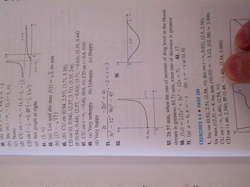

Here is when i am really stuck, how do we find the zeros for the second derivative?
BTW, pic of question and answer is attached. (number 53)

You have an equation for m and m' to substitute in, m''=0, so solve for v.
Shortcut - what would m''=0 tell you?
What would that mean for relativity?
Is that reasonable physically?
http://www.weburbia.com/physics/mass.html
Thanks, that helped alot. Have a great day.
