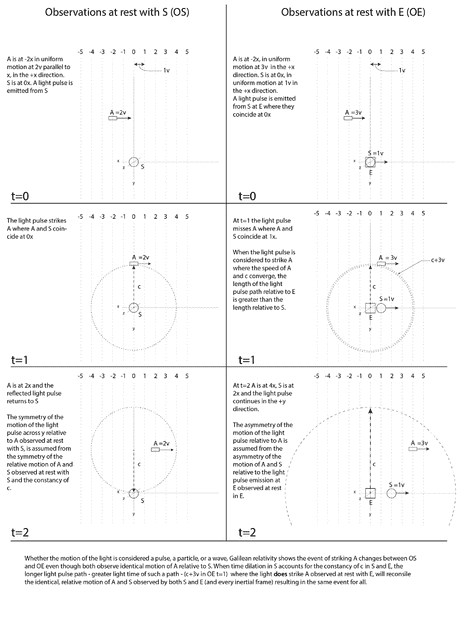

Whether the pulse strikes the mirror or not is not something determined by an observer’s choice of reference frame
Exactly! Therefore, if you agree, that the light-pulse strikes the mirror in the rest-frame of the light-clock, then you must also agree, that the light-pulse strikes the mirror in the other reference-frame.
  • #35
In fact, why don't we do some maths? Let's say an object at rest at the origin emits a pulse of light in the ##+y## direction at ##t=0##. The coordinates of the light pulse at time ##t## are therefore ##x=0, y=ct##. Plug in the Lorentz transforms:$$\begin{eqnarray*}
t'&=&\gamma(t-vx/c^2)\\
&=&\gamma t\\
x'&=&\gamma(x-vt)\\
&=&-\gamma vt\\
&=&-vt'\\
y'&=&y\\
&=&ct\\
&=&ct'/\gamma
\end{eqnarray*}$$So we can see that relativity says that the light pulse's coordinates in a frame where the source is moving are ##x'=-vt## and ##y'=ct'/\gamma##. The speed is still ##c##: ##x'^2+y'^2=(v^2+c^2/\gamma^2)t'^2=c^2t'^2## so the pulse is distance ##ct'## from the origin at time ##t'##. But its velocity has acquired an ##x## component so is not perpendicular to the ##x## axis in this frame.
These are two different descriptions of the same thing.
Yes I do agree. I never said otherwise.
The point of that example was that the choice of frame determines whether the mirror moves or not. That a moving target is struck by the same light pulse that strikes the non-moving target suggest there is a distinction in relative measures that is irrelevant to the physical events.
  • #37
AlMetis said:

AlMetis said:
I am not questioning that. I am questioning why that is contradicted in the examples I gave.
Why it is contradicted in the examples? It is contradicted in the examples because the examples you gave all had some mistake in them. That mistake has been pointed out for each example. You have been answered "why". Clearly each time.
The issue is not that you have not been given an answer "why". The issue is that you have not generalized or internalized the physics yet. That takes time and practice, it is not something that we can give to you.
AlMetis said:
When I am next to and at rest with the sun, I am at rest with where the light leaves the sun at any instant. A minute later I can still be at rest with the sun, but if I am, I am moving roughly 828,000 km/hr away from where the light left the sun a minute ago.
This should read:
"When I am next to and at rest with the sun, I am at rest in the sun's frame with where the light leaves the sun at any instant. A minute later I can still be at rest with the sun, but if I am, I am moving roughly 828,000 km/hr in the milky way's frame away from where the light left the sun a minute ago."
Why does this lead to a contradiction? Because you made a mistake and switched frames silently. To fix this make sure that velocities are always specified with respect to an explicit reference frame.
AlMetis said:
If I don’t know, or have no way to measure this motion of the sun/me relative to where the light was emitted from it a minute ago, that does not change the path of that light relative to any frame of reference. If that light hits the earth, every frame will see it hit the earth. The motion that determines whether that light hits the earth is not the motion of any frame relative to the earth, or sun. It is the motion of the earth relative to where the light was emitted. The earth is either on a collision path with the light, or not. The light does not change its direction to chase the earth.
No light path was changed relative to any frame. However you mistakenly cited velocities with respect to two different frames without explicitly mentioning which velocities pertained to which frames.
AlMetis said:
When A and B see S remain centered between them, you and I will predict the path of the light pulse emitted from S will be symmetric as observed by A and B.
This ambiguous and so it would be improved by explicitly stating:
"When A and B see S remain centered between them in their mutual rest frame, you and I will predict the path of the light pulse emitted from S will be symmetric as observed by A and B in the mutual rest frame of S, A, and B."
The phrase "as observed by" is a little ambiguous. It can either refer to the situation as described in some observer's reference frame, or it can refer to signals actually recieved by a specific observer. Either way, the meaning needs to be made clear.
AlMetis said:
When E sees A, B and S moving along a common axis (x) they will all be moving relative to where the light is emitted from S at any instant. Unlike me at rest with the sun, E remains where the light was emitted. With this “new” information, you and I will claim the path observed by A and B will NOT be symmetrical.
This is also ambiguous and should be written:
"When E sees A, B and S moving along a common axis (x) they will all be moving in E's frame relative to where the light is emitted from S at any instant. Unlike me at rest with the sun, E remains where the light was emitted in E's frame. With this 'new' information, you and I will claim the path observed by A and B will NOT be symmetrical in E's frame."
AlMetis said:
Why does what E measures change what you and I predict will be seen by A and B if the relative motion of A, B and S is all that determines the path of the light observed by A and B and that relative motion does not change?
By "seen by A and B" do you mean "in the rest frame of A and B" or do you mean "signals recieved by A and B"? Either way, what E measures does not change what you and I predict. But you should get in the habit of writing unambiguous statements.
I mentioned that you need to practice. The first thing to practice is writing clear statements and identifying ambiguities in unclear statements.
