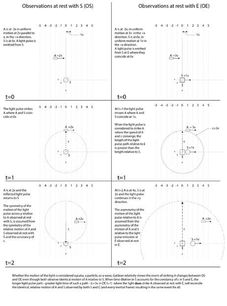

I have included another diagram that is (hopefully) less ambiguous than the word salads I’ve been posting.
The diagram plots the Galilean transformation of the same motion of source, mirror and light predicted to be observed by two inertial frames in motion.
The relativistic (Lorentz) transformations which hold the constancy of c in both frames, removes the (apparent) conflict of “different events” observed by each frame predicted by Galilean relativity. To remove the conflict, the slower time of the moving frame (S from E’s frame) allows it to measure a shorter length S-A of longer light path S-c+3v which holds S’s measure of light speed at c.
In other words, the shorter you measure a longer path, the slower your time must run to arrive at the same ratio of d/t = c.

Yes, the illustration is just showing there is a difference between frames, whether speed, aberration, length, time....something has to give to define the same physical event that is not apparent in the initial conditions of both frames.
Attached is a more legible version.

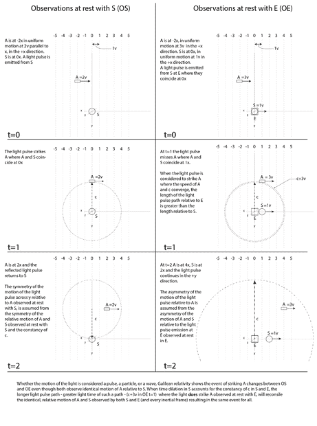

My diagrams show a distinction that is not made clear in most explanations of SR I’ve read.
When we are given the information on the left of my diagram, we have no reason to expect, or predict an asymmetry in the observations via Galilean or Einsteinian relativity.
When the same motion is observed relative to the light,(right side of diagram) Galilean relativity fails. It predicts what is not consistent with empirical evidence.
When we apply the Lorentz transformation from the left to the right, Einstein’s relativity works on the right (pulse strikes A) predicted observation equals evidence once more.
But we don’t regain the symmetry.
The symmetry is not exclusive to Galilean relativity, it is also predicted by Einsteinian relativity on the left and lost on the right.
Why did it disappear?
  • Sad

What symmetry are you talking about?
  • #71

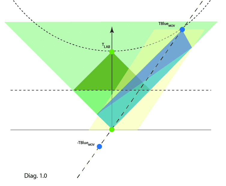

  • #74
I've marked the symmetry break in this copy.
  • #75
AlMetis said:
they do this by translating numerical values of a measure in one frame, to the numerical values of the same measure in another frame.
Lorentz transformations don't transform "measures", they transform coordinates.
AlMetis said:
What aspect of reality is defined in the need for the Lorentz equations?
The geometry of spacetime.
AlMetis said:
If they didn’t work and light was still a constant, reality would be different a very different thing.
You have no basis for this claim unless you have some alternate theory in which the transformations are different from the Lorentz transformations but the speed of light is still the same in all frames. And we already now such a theory is impossible if we accept the principle of relativity, because the POR only allows two possibilities, Galilean transformations (infinite invariant speed) and Lorentz transformations (finite invariant speed). In the former case, the speed of light is not the same in all frames. So your claim is assuming an impossibility.
Your diagram on the right is not correct for the SR case, so all you are showing is that Galilean relativity makes a wrong prediction.
  • #76
I don’t get it. I don’t know what you are calling asymmetry there

  • #82
Both sides are Galilean representations. The red line labeled ‘c_3v” on right side at t=1 represents the time dilated position of A relative to E (in principle, not to scale). If this is not correct, please explain why.
  • #83

  • #84
You and a number of people have said I have unknowingly switched frames of reference resulting in me mistaking the aberration observed in a “different” frame as a change in the observations in the same frame.
From everything posted, this seems to be the most consistent advice.
I need to understand at what point in time, I have switched frames of reference in context of what I think is being observed, in order to see/understand what would be observed.
So please indulge me one step at a time.
In the rest frame of the light source S and a mirror M at rest with S a fixed distance on +y, the path of the light pulse is observed perpendicular to x between emission at t=0 and reflection t=1, while S is in motion along x in the +x direction relative to the frame E.
Then
1. E will see the aberration of the light pulse from t=0 to t=1 as a path at an angle from x toward -x.
(when increasing x is in the right hand direction relative to you, the reader)Yes, no?
  • #85
Yes. The worldline of the light in ##S## is $$r^\mu=(t,x,y,z)=(t,0,t,0)$$ and in ##E## is $$r^{\mu'}=(t',x',y',z')=(t',-t' v, t' \sqrt{1-v^2},0)$$ using units where ##c=1##.
  • #86
Then
Probably yes. I would have said simply:
In a frame where the source and mirror are at rest, the light path is along the positive y axis.
In a frame, E, where the source and mirror are moving to the right (along the positive x axis), then the light path is at an angle to the x axis.
In terms of aberration, this means that when the light is observed in frame E, the source is further to the right than it appears when the light is received.

@ PeroK, yes, I will likely say more than necessary. It's a symptom of doubt.
2. The principle of relativity requires the laws do not discern one "inertial frame" from another when the Lorentz transformations hold the laws valid in all.Yes, no?
  • #88
Yes. Another way of stating this is that the laws of physics, both the differential equations and any associated constants, are the same in all inertial frames.
  • #89
AlMetis said:
How far apart are these coordinates?
The question makes no sense. You can ask what the spacetime interval is between two events (points in spacetime), but that's all.
AlMetis said:
I should have said the geometry of spacetime represented by the need to employ the Lorentz transformations between inertial frames expresses a continuum of fundamental dimension we don’t, but I would like to, understand.
Why do you think we don't understand it? You should not generalize from your own experience, because you evidently don't have a good grasp of SR, but that doesn't mean nobody does.
AlMetis said:
The basis I have is they “do” work , light “is” a constant and reality “is” what it is.
None of this justifies the claim I responded to. I gave you reasons why your claim was not justified. You haven't responded to those reasons at all.
Which means, as I said, that they tell us nothing about SR. But you said your claim about some symmetry not being there after switching frames applies to SR. What are you basing that on?
  • #90
Dale said:
Yes.
Thank you.
3. Then by virtue of 2, the motion of S is relative to the rest frame of E and the motion of E is relative to the rest frame of S, in that neither hold the equations 'More" valid in terms of the laws.
Yes, no?
