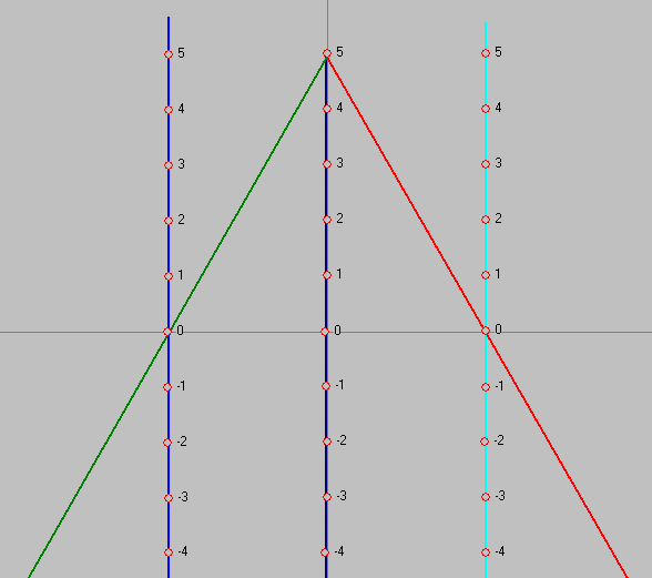

To do the math correctly just start with the scenario in B's frame, since that is easiest. Then apply the Lorentz transform to go to A's or C's frame. You will get a single collision event in both cases.

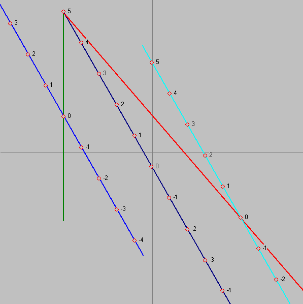

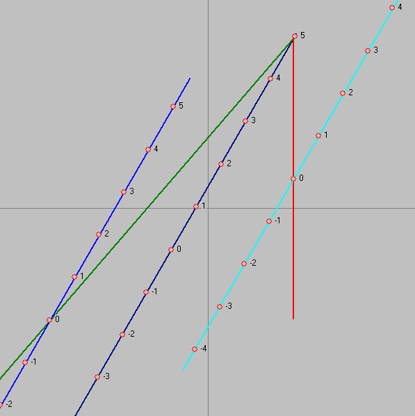

This problem will be be much easier to visualize if you start by drawing a spacetime diagram of the situation.
However, the key issue here may be that you've overlooked the relativity of simultaneity: if A and C are the same distance from B at the same time in the frame in which B is at rest, they are not in the frame in which A (and likewise for C) is at rest.
Try writing down the initial coordinates of A and C in a frame in which B is at rest at the origin, and then use the Lorentz transforms to find the coordinates of those events in the frame in which A is at rest. Look at the speeds of B and C relative to A, and it will be clear that all three objects come together at the same point in that frame as well as the frame in which B is at rest.

I think part of your problem is not taking into account that the collision is a single event in all three inertial frames. The event will have different spacetime coordinates in different frames, but that does not take away the fact that it is one event in all inertial frames.

That may be, but you didn't consider it when you drew the two time-0 initial states in the two sequences of snapshots above. Because of the relativity of simultaneity, they can't both look the same... you'll see this when you do the Lorentz transformations.

OK, since I can't resist...
Let's measure all distances in light seconds and times in seconds, to get rid of those annoying factors of ##c## that clutter up the arithmetic.
Just for the sake of simplicity, let's take the the initial distance between B and the other two to be ##1/\sqrt{3}## light-seconds, exactly one second (in the frame in which B is at rest) before the three-way collision. Now we have the following events, with coordinates in the frame in which B is at rest at the origin and all labeled as ##(x,t)##:
1: initial position of A: ##(-1/\sqrt{3}, 0)##
2: three-way collision: ##(0,1)##
3: initial position of C: ##(1/\sqrt{3}, 0)##
4: initial position of B: ##(0,0)##
Now transform the coordinates of these events into coordinates in a frame in which A is at rest and whose origin is the same as the frame above. In that frame the coordinates of these events are:
1: ##(-1/\sqrt{2}, \gamma/3)## where ##\gamma=\sqrt{3/2}##
2: ##(-1/\sqrt{2}, \gamma)##
3: ##(1/\sqrt{2}, -\gamma/3)##
4: ##(0,0)##
(Wise people will check these results, as I've made errors keying in Latex in the past)
Note the relativity of simultaneity at work: in this frame A and C are the same distance from B at different times, while in the first frame they were the same distance at the same time.
You can see that B is ##1/\sqrt{2}## light-seconds away from A at time ##\gamma/3## seconds before the collision; moving at speed ##1/\sqrt{3}## B gets there right on time. C is farther away but starts sooner and moves faster, so also arrives right on time.

As per Nugatory's suggestion, here are space-time diagrams for the scenario. For better clarity I added two other references which represent points equal distances from B and at rest with respect to B. I also added clocks to B and these two reference points.
The first diagram is for B's frame
Space-time diagram in one frame: vertical blue line for B with clock ticks 0 to 5, green line for A rising from lower left and red line for C falling to lower right, meeting at B's time 5; cyan reference lines at equal distances, each with clock ticks 0 to 5.
The dark blue line is B. The light blue lines are the reference points. The green line is A coming in from one direction and the red line is C coming in from the other direction. A and B pass the reference points when the clocks there and the clock at B read 0, and meet when all three read 5.
Same scenario from A's frame.
Space-time diagram in one frame: blue line B with tick marks 5 to -4, a green vertical line A, a red line C, and a light blue reference line with tick marks 5 to -2, all meeting near the 5 mark.
A still passes the reference point when the clock there reads 0, However, the clock at B and the other reference point do not read 0 at this moment. B's clock reads between 1 and 2 and the reference reads between 3 and 4. C passes its reference point when the clock thee reads 0, just like above, but according to A, this happened before A passes its own reference point. Again A B and C meet up when B's clock reads 5
In C's frame, things look like this
Space-time diagram in one inertial frame with time on the vertical axis: a dark blue worldline for B, two light blue reference worldlines with numbered clock ticks, a green line for A and a red line for C, meeting at tick 5.
It is basically a mirror image of what happened according to A, as according to C, A passes its reference point before C passes its reference point.
