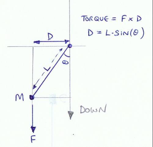

Clearly the weight cannot be lifted to θ = 90 as 4000lb * 4ft > 4000 ft lb
so static equilibrium will be reached where 0 < θ < 90
Draw a free body diagram, apply equations of static equilibrium (just ΣM=0 is needed) then form an expression to solve for θ.
Hi billy. The result. At 90 degrees the applied torque equals the weight of the suspended mass. At 45 degrees, 1/2 the suspended weight. It's a simple mathematical relationship! Thanks for your assistance in getting my head around this.
I would have thought the function needed would be a sine, so that at 45° you would get 4000lb x 4ft x sin(45) = 16,000 x 0.707
Alternatively, the weight is 4000lb and if only 4000 ft.lb is available the angle would be such as to make the offset from the axle 1 foot.
4ft x sin(th) = 1ft
th = asin(1/4) = 14.5°

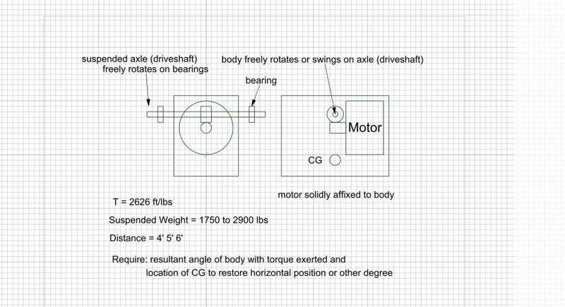

Clearly, I am in over my head.
What I require is a formula where I can plug in torque using ft/lbs, horizontal distance of CG from axle in feet or inches, and weight in pounds.
I require degrees from horizontal, and offset of CG to maintain horizontal or another degree.
A lab set up with a pendulum having a low mass rod and ball bearing pivot, and using an accurate pounds gauge, resulted in a 45 degree reading of 50%! That threw me off.
It is extremely important that I get this correct. Your help would be greatly appreciated.
Further, the actual figures I'm working with are T = 2626 ft/lbs Weight = 1750 lbs and 2900 lbs, and D = 4' and 5'.

The axle is driving a resistance with a resultant torque of 2626 ft/lbs

The motor is driving an axle which is driving a resistance ( not shown) that generates torque. That torque would spin the body around the axle if the axle was fixed.
Maybe this will help. Think about the anti-torque rotor on a helicopter. But, instead of being a simple torque moment problem, we have a suspended weight.

Here is the problem simplified. I think I should have presented the problem like this:
A pendulum bob of mass M, and having a rod of no mass and a length D, pivots from a bearing having no friction.
A force F is applied tangentially to the pendulum's arc to the mass M.
Compute new angle after F is applied to M
In a conversation I asked @Designman to clarify what his actual problem is . This is his reply :
A common driveshaft connects two machines.
Between the machines a chassis hangs freely from that driveshaft.
A power source is rigidly attached to the chassis.
The power source rotates the driveshaft at a constant RPM through a transmission.
The machines offer a constant resistance to rotation.
The center of gravity of the chassis is directly below the driveshaft.
The chassis hangs horizontally.
The weight of the chassis counter reacts the torque applied to the driveshaft.
Friction and startup torque is ignored.
Torque is constant
What is the resultant offset of the chassis with torque applied?
This may seem a trivial problem but in reality it is not .
You have to have a restraint of some kind to stabilise the chassis otherwise it will just swing about in an uncontrolled manner when under load .
A rigid link or a damper system could be used .
Any more help would be appreciated. Still stumped.
