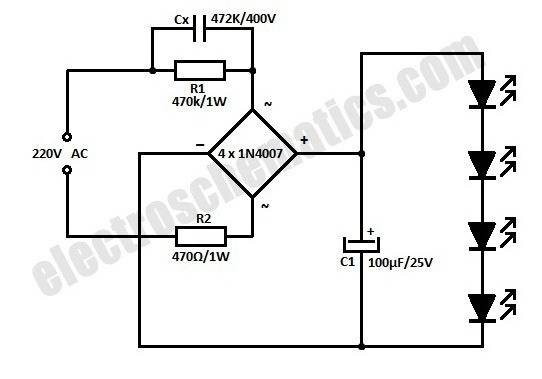

I want to power a led off mains, here's my thinking on it:
resistor-->led-->1n4009 to protect against reverse breakdown voltage, is there anything I'm missing and will it be reliable?
Im a bit unsure if I should be giving you circuit advice for mains powered projects
as I don't really know if you have the experience dealing with potentially lethal voltages
The way you described above isn't correct
You also haven't stated what mains voltage you have at your location or what type of LEDs you want to use
This gives me even less confidence in your knowledge level
The circuit I will give and strongly advise you follow and with skilled supervision is this one ...
Dave
it's just 120 v ac, I don't see why I need a bridge rectifier and cap when all I want to is current and voltage limit a 1.2v led and use a 1n4009 to protect the led against reverse piv? maybe I'm not using the right terminology but I'm comfortable working around mains, I'm pretty sure I won't die. would you have questioned me if I had used a neon bulb and a resistor? basicly it's a half wave rectifier and I'm just adding a voltage drop and current limiting. if I used a varic and fast blo fuse, high wattage resistor I would test this out myself before asking, just wondering.
