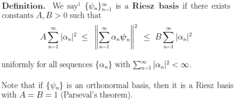

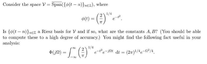

Determine if {phi(t-n)} is a Riesz basis for the space V = Span({phi(t-n)})
The definition of the Riesz basis used for this problem is included below.
The reference definition and problem statement are shown below with my work shown following right after. I would like to know if I am approaching this correctly, and if not, could guidance be provided? Not very sure. I'm not proficient at formatting equations, so I'm providing snippets, my apologies. Thank you.
Problem:

I think I can do one direction, and it didn't require any equivalence theorem, but it was slightly non obvious. The other direction eludes me but is probably similar.Let's start with the simple step. Can you compute
$$\left<\phi(t-m),\phi(t-n)\right>$$
Edit to add: actually the other direction is basically the same. There's just one epsilon-clever trick I think once you compute the inner products to get over the finish line here. I doubt I got the optimal constants though.

Judging by the hint given (the Fourier transform ##\Phi(\Omega)## of ##\phi (t)##) can't we say that the problem want us to make use of the equivalence theorem?
Does your method use the hint?
Delta2 said:
Judging by the hint given (the Fourier transform ##\Phi(t)## of ##\phi (t)##) can't we say that the problem want us to make use of the equivalence theorem?
Oh that's funny, I thought the hint was just telling you in a roundabout way how to compute the inner product of two of these things. I guess this makes more sense to me why you would use this theorem on Wikipedia now.
