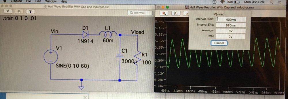

I hope I am posting this in correct forum section. I just downloaded LTspice for my Power Electronics course. Does anyone know if the software can display the DC component of a waveform such as found by determining the Fourier series of a waveform?
berkeman, I did take notice of that post. I tried this on a Mac and PC and still could not get any results no matter what I clicked. I must be doing something wrong.
Maybe post some screenshots? The "average" voltage should be the DC voltage. Are the functions not working, or are they giving you answers that don't seem right?
All I get is zero’s.

I believe that you are looking at too short a part of the plot as the voltage is still increasing from the initial conditions.
RMS must be computed over a time period. To avoid window errors, the number of cycles in that period must be an exact integer, or be very large.
Read help for waveform arithmetic; Section 2. "Compute the average or RMS of a trace".
Select the plot window. Hold down the control key while you left click the mouse on the trace label.
Read the report in the small window.
For your circuit between exactly 1 and 2 seconds, the average is 5.2756V, the RMS is 5.2759V.

I think I may have been the victim of the “always zero” bug. I’ll have to check out the Yahoo group that someone posted here. I’m not a member of that. I contacted the developer and I was asked if I synced my release. I was not sure what that meant but I uninstalled the app from my Mac and reinstalled. This time I noticed that my security settings didn’t recognize the developer. So, I had to approve of the install in my settings. Everything is working fine now. Thanks for the replies here.

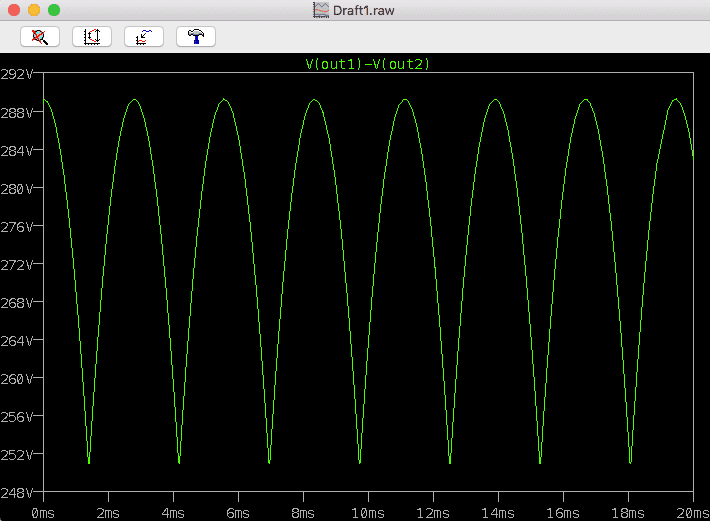

Now that I got the bug out of the way, I can move on to what I was trying to accomplish in the first place. I wanted to prove when RMS and a DC average are the same values and when they are not. I am learning 3-phase rectifiers and the textbook was using the DC average of the pulses to calculate the power output of the diode network. This was a beginner circuit and the load was just a resistor with no capacitor for smoothing out the pulses. I questioned my instructor why RMS wasn’t being used. It turns out from LTspice that the RMS and DC average is the SAME thing! I find that hard to believe.
Here is my circuit and the waveform of the voltage across the resistor.

If you have a one volt AC to a full wave rectifier, the DC average of the DC pulses will be .636 but the RMS of same will be .707. What voltage would you use to calculate real power to a resistive load?
The mean energy per unit time (i.e. average power) will be the RMS value - whatever the waveform. The Mean Voltage for the AC signal is zero but the mean of the rectified signal happens to be 0.636V. There is more than just the DC power in the rectified signal as there is an 'AC Component'.
Take another, SIMPLER, example. A +/- 1V square wave has an RMS value of 1V and that is the same as the RMS value for the full wave rectified signal (1V). The mean voltage for the square wave is zero but the mean voltage for the rectified signal is 1V (it's 1V all the time).
sophiecentaur, Thanks. It clicks better when you consider a square wave. I think where I have been going wrong is that I was using calculus to determine the average value of a full wave rectifier to calculate the real power to a resistive load. So, for a 1V AC rectified waveform, full wave, real power would be equal to .707 squared divided by resistance. Is that right?
It depends on what exactly you mean by “1V AC”. It is true for a mathematical sinewave with peak amplitude = 1.
A 1.0V amplitude sinewave generated by LTspice is a ±1.000 Vpeak sinewave = 0.7071 Vrms = 2.0 Vpeak-peak.
If you rectify it perfectly, it still has 0.7071 Vrms, referenced to zero.
A 1.0 Vrms sinewave has a peak amplitude of ±1.4142 Vpeak = 2.8284 Vpeak-peak. For sinewaves in the commercial power world, VAC is assumed to be Vrms unless otherwise specified as say Vp or Vpp.
