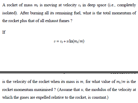

Hey,
I have a question on a rocket in deep space (all external forces negligible), basically I'm doing something wrong the latter part of the question - maximizing the momentum via differentiation, here's the question:
So the momentum at a given mass 'm' is :
[tex]p=mv_{i}+muln(\frac{m_{i}}{m})[/tex]
I attained a derivative of respects to 'm' as:
[tex]\frac{\partial p}{\partial m}=v_{i}+u(ln\frac{m_{i}}{m}-1)=0[/tex]
Giving 'm' as :
[tex]\LARGE m=m_{i}e^{\frac{v_{i}}{u}-1}[/tex]
Which is wrong according to the solutions unless I assume v(i)=0 which I don't think I should.
Where am I going wrong?
Thanks guys,
SK
Remember that momentum is a vector not a scalar.
Are you sure that is a maximum? (hint: ∂p/∂m = 0 is a necessary but not sufficient condition for a maximum).
Sekonda said:
Giving 'm' as :
[tex]m=m_{i}\,e^{\frac{v_{i}}{u}-1}[/tex]
That's correct.
That is a reasonable assumption for this problem.
I can see that my earlier comment, made on the assumption that you did have an error somewhere, could be read to imply that your solution is not a maximum, when in fact it is. I apologize for any confusion my comment may have caused.
After doing the actual calculation I too concur that your solution gives maximum momentum in the interval 0 ≤ m ≤ mi or, equivalently, when vi ≤ u.
