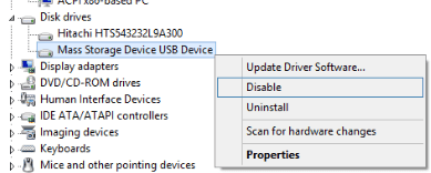

When we cannot safely remove our usb memories and disks what are the other options? Sometimes we cannot safely remove them and take a notification. According to that notification a program is using the drive so we cannot remove it at that moment. Do you know what the error code for this situation? And is removing the drive from device manager a safe option?

I don't believe there is an error code associated with that. The device is obviously still in use - being read from and/or written to. You need to wait a while and attempt to safely remove the USB (or whatever) again.
