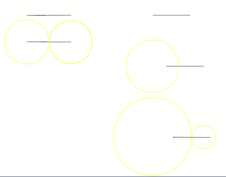

name123 said:
So how does the visualisation you provided explain the same time logged for the spaceship flashes, between the satellite to the left and right of the satellite passing the passing ship (of whose perspective we are imagining) and the satellites to the left and right of the opposite satellite (from the one passing the ship)? Presumably those distances from north/south flashing spaceships are not the same. Nor their next positions.
well as with any scenario where you have relative motion, you do have to take the relativity of simultaneity in account.
To demonstrate we will just consider linear motion.
Below is a rod from which light flashes initiate at the ends To the left is how events occur according to the rod itself. The flashes start at the same time and the expanding light meets at the center of the rod.
On the right are the same events according to someone for which the rod is moving at 0.5c to the right.
The flash from the left end of the rod starts first, and the light expands outward at c while the rod continues to move to the right.
After the rod has moved some distance, the second flash leaves the right end, and expands out at c. Both flashes continue to expand as the rod continues to move to the right until they meet, again at the middle of the rod.
Diagram of three pairs of yellow circles with a horizontal dark line segment in each, showing a rod of equal length at each stage of relative motion, with light flashes shown at the rod ends.
The fact that the light meets at the center of the rod is an invariant fact for both frame. Whether or not each flash started at the same time is not.
So in your scenario, the fact that flashes from the spacecraft arrive at all the satellites simultaneously in one frame does not mean that they arrive simultaneously in all frames. In the same way, the fact that two satellites are always in sync when they pass each other is an invariant fact doesn't mean that they remain in sync at all points of their orbits in all frames.
  • Diagram of three pairs of yellow circles with a horizontal dark line segment in each, showing a rod of equal length at each stage of relative motion, with light flashes shown at the rod ends.

No you I was not asking what a satellites clock shows at the same time as another satellites clock reads 00.01, 00.02 etc. I had tried to explain what I meant in post #82 when I wrote:
name123 said:
Just to be clear what I meant, is that at no matter what part of the orbit the satellite is, its observational relationship to the other satellites in its series does not change. So that if there were no defining features on the "sphere" and no other things in the universe other than those being considered, you could not tell from photographs which part of the orbit the satellite was in. If you were already clear on that, then I am not sure what is arbitrary about it. Perhaps you could give an example of how it is arbitrary?
You can imagine that the pictures do not give you sight of whether the other satellites (in the same series) have clocks or not.

I am not quite clear on what the different symbols mean, but are you suggesting that if one of those transformations were chosen, that you could tell from pictures taken from one of the satellites (imagine none contain clocks, and so no clock can be pictured), that you could tell where it was in its orbit (perhaps from how far apart its neighbouring satellites appeared from it or from the centre of the "sphere")?
