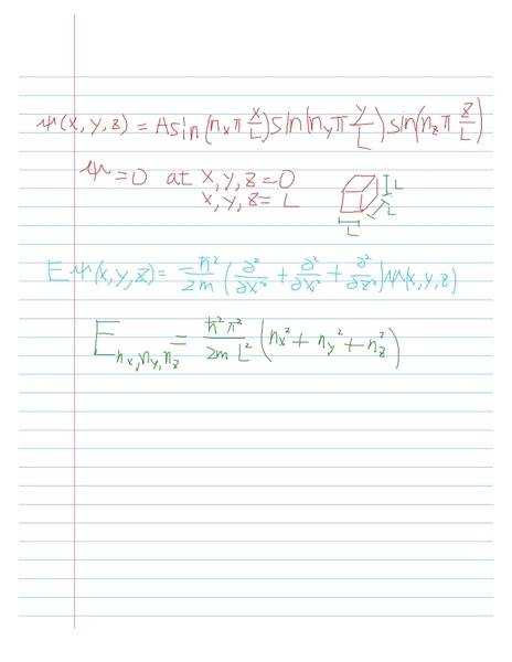

I was doing a problem: An electron is confined within a three-dimentional cubic region the
size of an atom where L = 200 pm.
and I remembered somehow, my teacher gave me these equation
do they work in such condition?
That's the solution to the infinite square well problem in three dimensions. Here is a derivation for the solution in one dimension, you can generalize it to three.
The first equation is the time-independent portion of the wavefunction, and the second line contains the boundary conditions. Since the outside of the box is an infinite potential, no particle may be found there. So, ## \psi ## must take a value of zero at the edges (0, and L). The third line is the time-independent SE in three dimensions. Finally, the last line gives you the energy levels, which you should notice are quantized by the principle quantum number (n).
