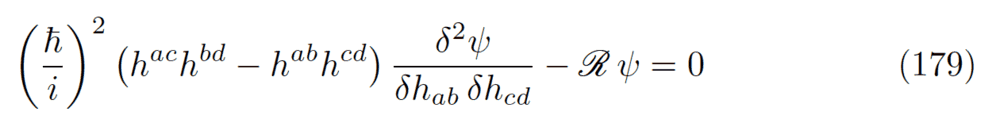

I pulled them and separated out the relevant eight pages from the whole in a pdf. The concluding few paragraphs are worth a quotation here:
We summarize by stating the formalism of this "theory". The Hilbert space is the space of all complex-valued functions Psi(h(ab)) on the space of positive-definite metrics on S, such that is invariant under the action (on h(ab)) of dieomorphisms on S, and such that
We put theory in quotation marks because we have here merely an equation and a few words. What does it all mean? What is the measurement situation? What would it be like to live in such a quantum space-time? What is the correspondence limit? To what extent have the principles of quantum theory been incorporated? To what extent is this theory a "fuzzing out" of general relativity? What alternative formulations are available, and how do they compare with this one?
We are today a good way from satisfactory answers to questions of this sort.
