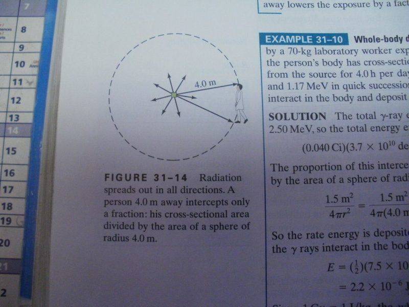

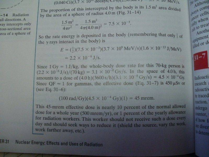

Here is a example problem in 5th ed Physics Giancoli
Thanks for the reply. I've learned something from this at least but I think I'll leave it out of my report; I believe this is above my knowledge and I don't want to dive into something and waste even more time than I already have on this assignment lol. Thanks again mate :)
