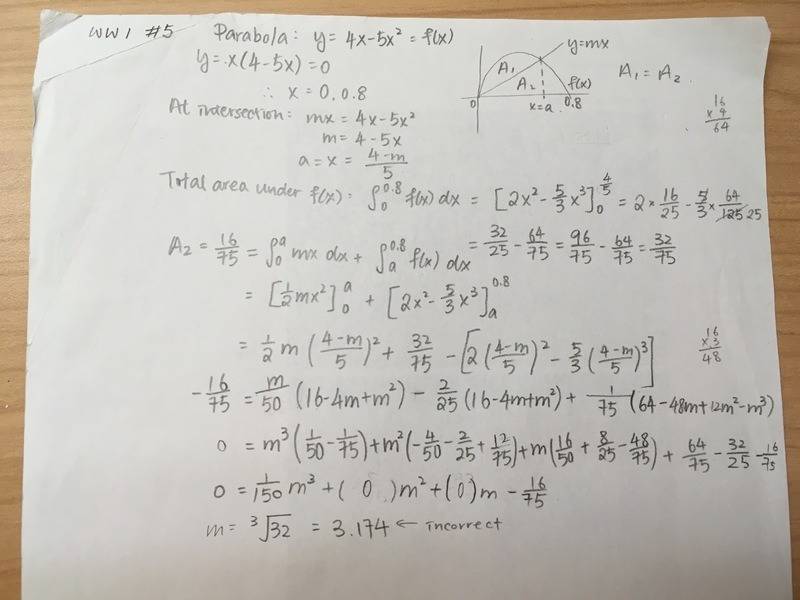

Typeset text problem: There is a line through the origin that divides the region bounded by the parabola y = 4x - 5x^2 and the x-axis into two regions with equal area. What is the slope of that line?
Integration of graph is the area.
Handwritten calculus working on lined paper for a parabola area problem with y = 4x - 5x^2 and y = x(4-5x), showing intersection points x = 0 and x = 0.8, integrals of the two curves, and a final value 3.174 marked incorrect.
I don't think my way should have any problem in it, but I can't get the right answer.
Are there any careless mistakes in it? Or any other problems?
And how is the true answer get? And what is the answer?
Thank you very much

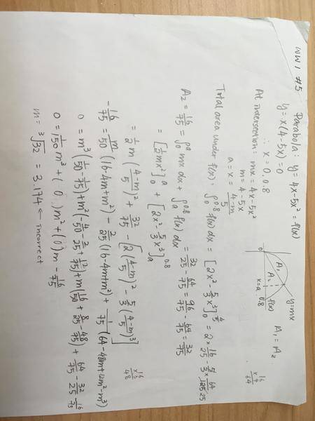

Handwritten work, rotated sideways, titled HW #5 Parabola: y = 4x - 5x^2 = f(x), finding the area between the curve and a line through the intersection points at x = 0 and x = 0.8, with integrals and a final value of m = cube root of 32 = 3.174 marked incorrect.
Thank you very much
I refuse to lie sideways to read your work. Anyway, the preferred method in this forum is for you to type out your solution; some people will look at photos of solutions, but only if they are properly oriented.

Handwritten worked solution on lined paper for WW1 #5 on the parabola y = 4x - 5x^2 and the line y = mx, with area equations and an incorrect final value m = cube root of 32 = 3.174 marked.
sorry for the problems. i didn't aware of them. hope you may help with this. thank you
Your total area result is correct. Computing A2 instead of A1 seems easier, since you do not need to break up the integration region into two parts: you just have ##A_2 = \int_0^{x_m} (4x - 5 x^2 - mx) \, dx,## where ##x_m## is the positive intersection point. From the requirement ##A_2 = (1/2) A## I get the equation
$$ -\frac{1}{150} m^3+ \frac{2}{25} m^2-\frac{8}{25} m+ \frac{32}{75} = \frac{16}{75},$$
leading to a much different ##m## than yours.
