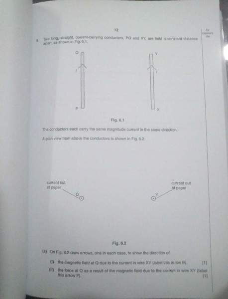

Simple Magnetic Field Question.
gabloammar
73
In the attachment.
The left hand rule. [and the right hand grip rule maybe?]
Aren't we supposed to have two of three things [out of direction of motion, direction of current, and direction of magnetic field] to find the third thing? I'm stuck at the the first question so I can't really move on to the next one. Could someone please help?
I don't know where to start. I checked my textbook and I don't know what information to use from it. It's not making a lot of sense. Could someone please help?
  • Printed exam page showing Fig. 6.1, two vertical parallel conductors PQ and XY with upward currents I, and Fig. 6.2, a plan view with current out of the paper at Q and Y, and parts (a)(i) and (a)(ii) below.
hi gabloammar! :smile:
no, that's a different hand! :biggrin:
the one you want is with the thumb pointing along the current, the fingers curl round the wire in the direction of the magnetic field …
see hyperphysics for the best diagrams! :smile:
Thanks for the reply!
That's the right hand rule then isn't it?
And I wanted to ask, what's the difference between the right hand grip rule and the right hand rule?
the right hand grip rule has only two directions, the thumb and the curling fingers
the right hand rule has three directions, the thumb, the index finger, and the other fingers :wink:
