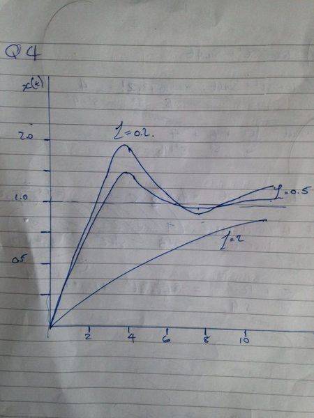

I've got this question to a point where I'm happy with it. Thanks for your time.

Hi Gneill/Gremlin
I've had a good read of my learning material and done some googling, so trying to mate sense of it
I was calculating Td , Tr , Tp , Ts and Mp, to sketch my graph, which was fine for ζ less than 1.
I realized that things wouldn't be straight forward as β = cos^−1 (ζ )
I have seen plenty of sketches showing values of zeta up to 5, but how do I go about plotting these.

Investigate the solutions to the differential equation. The form of the solution for the various damping cases is different. The wikipedia article I mentioned previously (for the RLC circuit) shows the mathematical forms.
Also note that the question asks for sketches, not plots. You may be overworking the problem.
I know that they only say sketch, but they give you values of zeta and wo, which can be used to calculate:
1. Delay time, Td2. Rise time, Tr3. Peak time, Tp4. Maximum overshoot, Mp5. Settling time, Ts
Which is fine for the first 2 lines, which are under damped (zeta=<1), but have throw in the third where zeta=>1, so you have to go a step further in your study.
Confused [emoji20]

ask yourself if a system is overdamped, is there an overshoot?
No, and I can see that clearly on many graphs on the subject.
so an overdamped system will slowely rise to the end value, kind of like a first order response. You'll see that it will never actually reach 100%, and will not have any overshoot
Yes, I also understand that too. I guess the formulas I'm using are only valid for values up to zeta=1. I think that, what I'm currently studying only scratches the surface of this subject.
Why I've questioned this and because they don't just give you a value of Zeta, but also include a value of an I damped natural frequency wo. Why give both values to sketch a graph after all?
Are there any relationships between different values of Zeta, as you can clearly see the waveforms differ in frequency (looking at values of Zeta from 0.1, 0.2, 0.3 etc)
